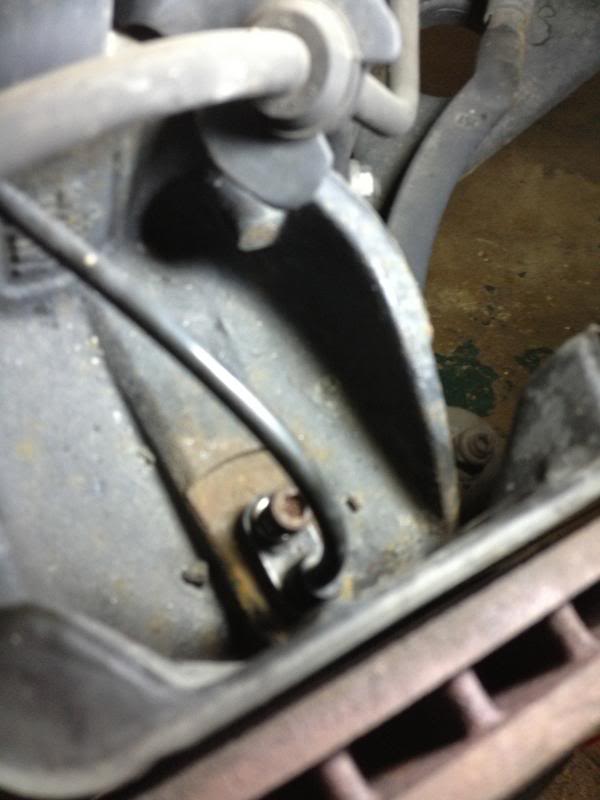

just confirming this picture shows wheel speed sensor connection next to the brake pad sensor correct?
Old Jun 25, 2013 | 03:53 PM
  #83
AKIndiMini's Avatar
AKIndiMini
Joined: Oct 2006
Posts: 8,011
From: Kodiak, AK
Yup, that's it!

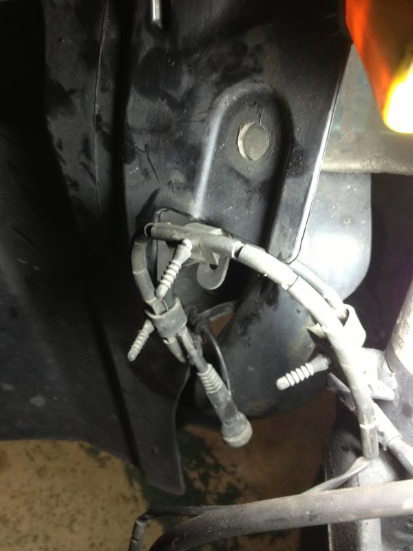

Ok just finished my test drive lights are off
Thoughts to add
The left and right front sensors mount differently. the drivers side sensor wire mounts to the brake pad sensor wires (which have rubber clips attached ). they are easy to unclip and reclip pics below
Also it is clear that the mounting position left and right are different. The picture posted above in post 82 show the drivers side where the blue end of the cable sits in a white C-clip. On the belt side of the engine the blue end is held in by a zip tie attached to a gromit as posted above in the pics of this thread.
Don't be confused if you do both sides, sensors are the same they just mount differently.
The most challenging (difficult ) part of this procedure is actually getting the old sensor out of the hub carrier. By no means was removal easy. Pull straight up was not doing it.
My strategy was to use a vice grip along with two flat blade screw drivers to shimmy the sensor up. each side took 10-15 minutes. Insertion of the new sensor was far easier.
Have patients they will come out.
here is a good view of the sensor head in the hub carrier (located behind the disk at 12 noon)
great info here as always if it were not for removing the old sensors this would be easy smeary
