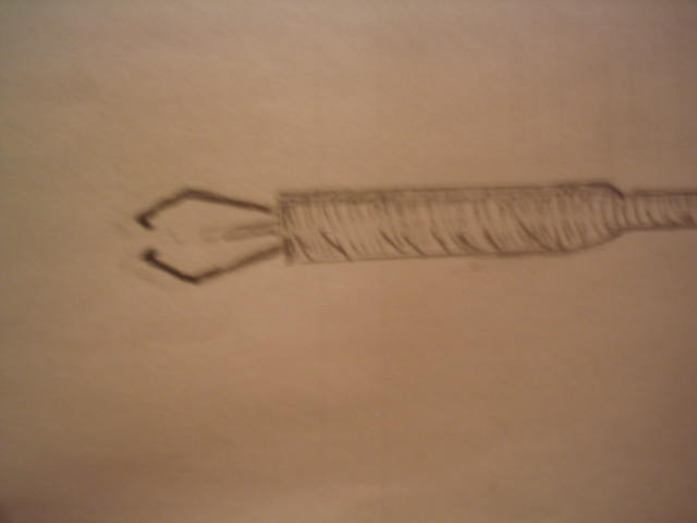

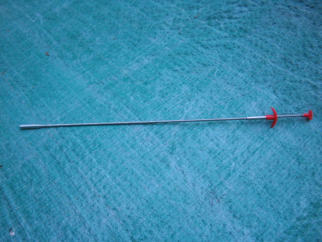

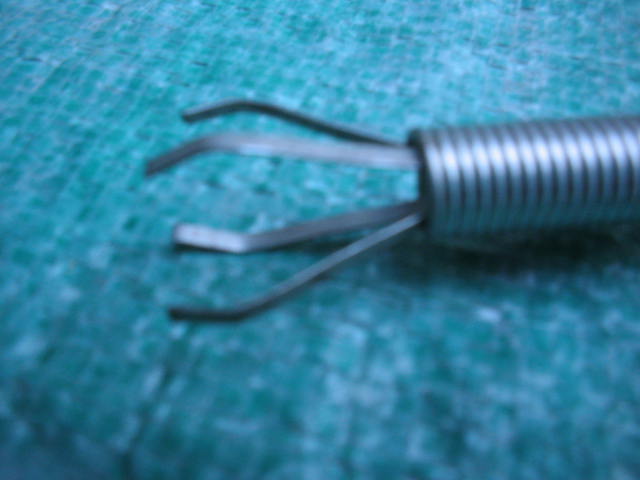

Just a suggestion but I think it will work
I have one of these flexible grabber tools (see Pictures) that if modified should do the job.
If you take some needle nose pliers and gently bend the claws at the tips inward so that they point back inward toward the center you will have a pretty effective claw for for grasping the broken dip stick to pull it out.
You will have to visualize a bit from the drawing.

Interesting where can I get one of those gadgets? The only issue I see is it may not have the gripping power to pull it out.
If there was tool that that went around the dipstick and I could twist it on that might work. I am will to try anything.

Bend between the end and the last bend so that the claws will grip and dig in.

From: Ellicott City, Maryland USA
Most any auto parts store that sells tools or Sears will have them, they aren't expensive. In their standard form they wouldn't work, they would just slip off. Oh gripping power? Just put your finger in there and release the spring tension and get out the bandages.
