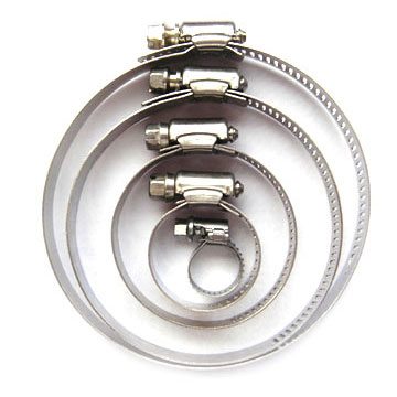

Oh those Europeans and their "fancy" clamps just couldn't have "regular" clamps on their hoses and had to design new and improved ones for their special cars......
Attached Thumbnails What is the correct power steering fluid to use?-hose_clamp.jpg
