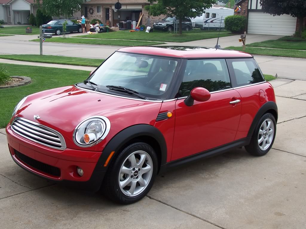

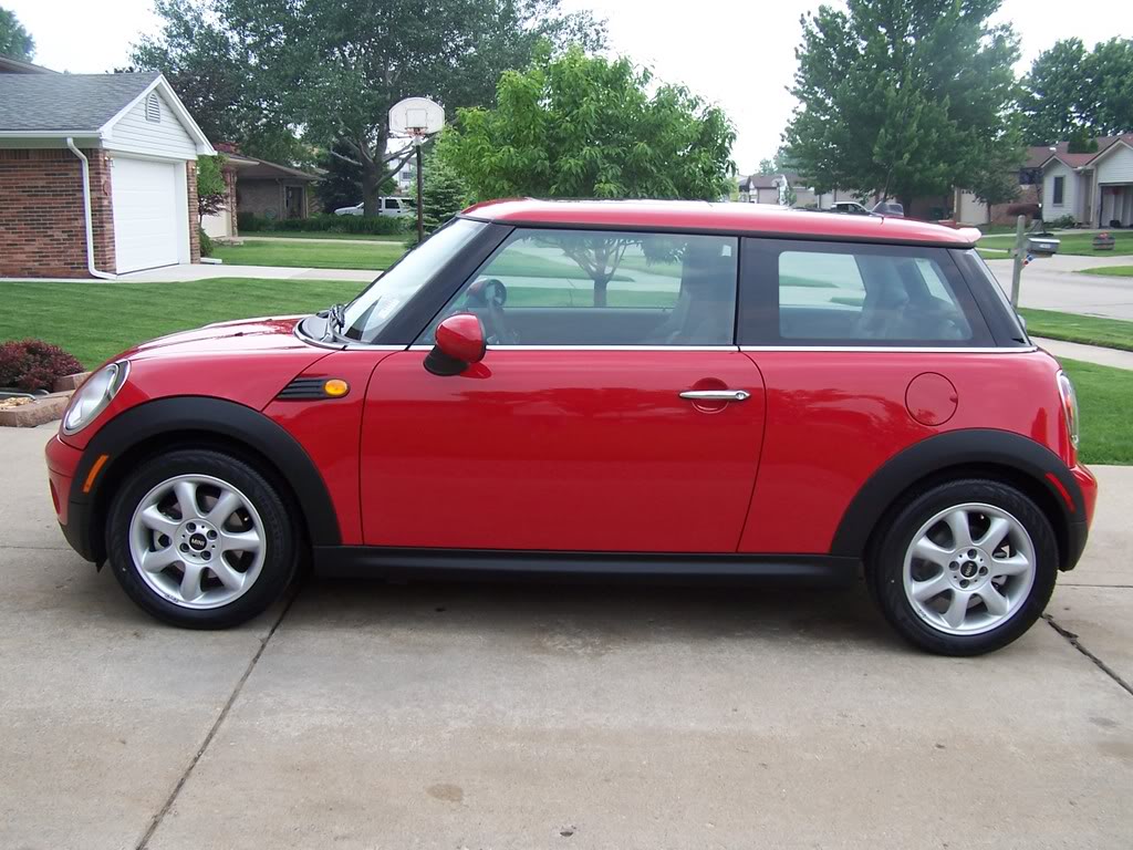

My rental MINI
Fresh after hand washing, applying a coat of Klasse AIO, dressing the tires and cleaning the windows inside (yes, I'm a detailer and proud of it )
Just and FYI, when I was trying to remove some dried on bugs from the front of the MC, some of the red paint came off on my pad, ah the joys of non-clearcoated paint IMO the extra $450.00 for metallic is WELL worth it, just for this very reason. That being said though, I love Pepper White w/black

I like the rental MINI! Im glad things are progressing well at the dealership, hopefully they will get it all figured out and have it fixed for you soon.
BTW - Youre very nice to wash the rental. I never once washed mine, it was a disaster. You say youre a detailer? When can I drop off my MINI?

Holy cow - you detailed the loaner? For pete's sake, I should have lent you mine...
