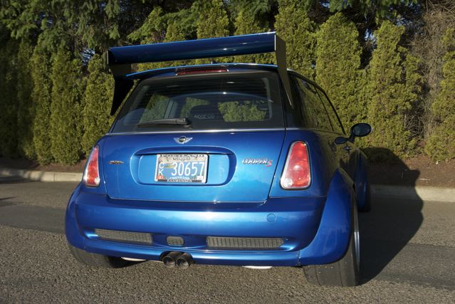

Flares for the 15x10 wheels
Hi,
I thought I'd share a couple photos of the finished car... I just put on the custom-made flares to cover the wide tires. Added the wing too.
Attached Thumbnails Hoosier's 275/35/15-dsc_0001.jpg   Hoosier's 275/35/15-dsc_0019.jpg

Originally Posted by mzman
Hi,
Sweeet! I likey alot....
