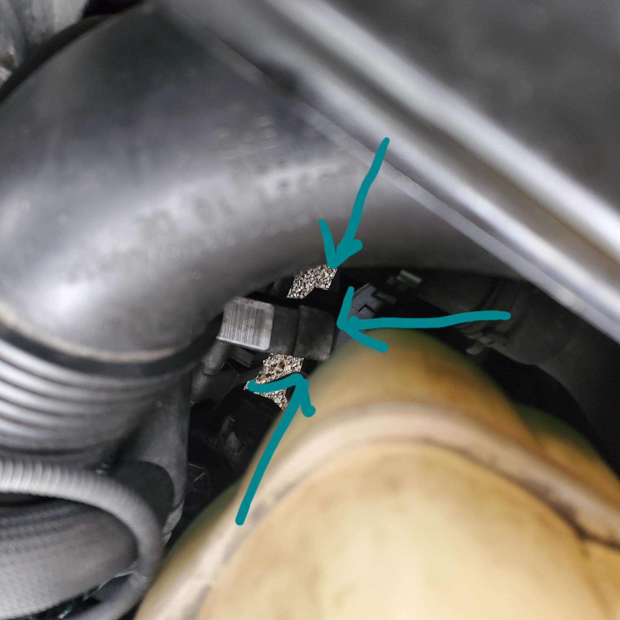

Clutch "Clunk" Noise: Please help me identify this bar?!?
Recently I developed an random "clunk" when I'm releasing my clutch. It doesn't happen all the time...mainly when switching from reverse to 1st when starting up a hill... if I'm shifting slow on level ground I don't get the noise. I've identified what sounds like the problem, (when I use the handle part of a hammer and push this back downward, I am able to duplicate the sound) but I have no idea what this bar is called, so I can get what mount or bolts I need to fix it...because everything I need for any repair on my baby...is always special order where I live 🤦🏼‍♀️
It is located directly under the manifold hose that goes to the outside of the car. (not the one that goes from the engine to the supercharger) if your standing in front of the car looking down on the engine, it's to the left of the transmission mount.
I'd just really like to have what I need on hand, so I don't have to take everything apart twice 🙄
Thanks in advance! Happy motoring!
The bar is under this hose

That is the shifter counter weight. My guess is motor mounts are getting worn…

***update***@njaremka you were 1000% right! Thanks for pointing me in the right direction! I really appreciate it!
