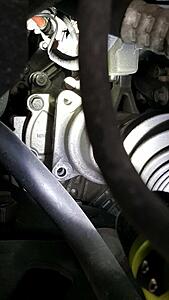

Definitely posted in the wrong spot the first time, so I'm reposting here.
I've got a 2011 Countryman S All4, manual transmission.
Got the tires swapped out and an alignment today and the garage claims these two bolts are just plain missing. Seems odd to me they'd just disappear, but they're not there, so I do need to find their name/part number so I can get them replaced.

It is a bit difficult to tell what we are looking at in the pic but it might be part #4 in realoem diagram.
http://www.realoem.com/bmw/enUS/show...diagId=31_0909

http://www.realoem.com/bmw/enUS/show...diagId=27_0063
Maybe #6 here?

This makes more sense. I think RR nailed it.
