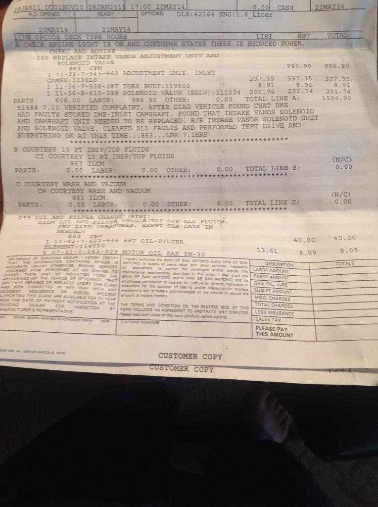

I recently added a oil additive in my engine and threw all sorts of cel codes and ended up having to take it to the dealership. Long story sort I clogged up a VANOS solenoid and had to replace in and it's unit.
This is a video of a cold start after the dealership worked on it.
Timing was 1/8 off. I always talk to the mechanic. Never the service rep.
------Don't use this stuff!!!------
Proof(cars is at 52000 miles so I had to pay out of pocket)
Just wanna let the NAM community know so it doesn't happen to anybody else.
