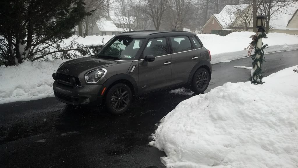

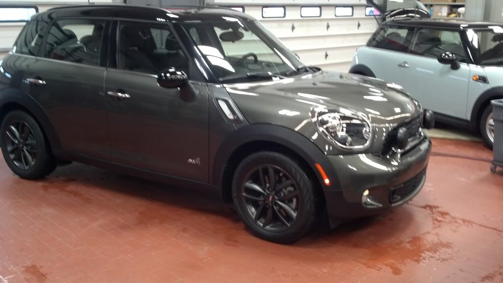

I did forget the obligatory pictures. From the day we bought it. One clean in the shop, tho other after we drove home in the snow.

All's well that ends well! Nice looking Countryman! You'll love the Xenons and black wheels (easier to clean)...and BTW if you ever need to rock your MINI out of deep snow, don't forget to turn-off the DSC (like me) or you won't get anywhere at all!
