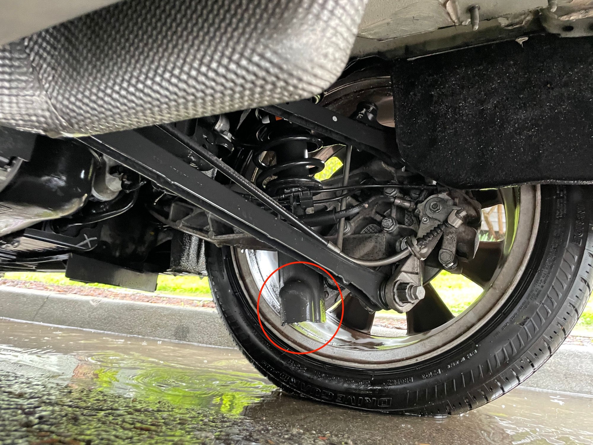

Hey guys, I have a 2013 R59 and today I noticed something sticking down from the right rear tire. It almost looks like something was cut/broken off but I'm not sure what it would be...? It's the red circle in the picture. The car runs fine and shows no warning message. Was wondering if someone on the forum could help identify what this is. Thank you in advance!!

That is a stone guard that protects the lower mount of the rear shock. It just clips on to the lower mount.
This thing:
https://www.ecstuning.com/b-genuine-...n/33506851235/

Yep, i had one of those fall off my R58. Its a protection cover.
