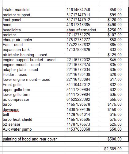

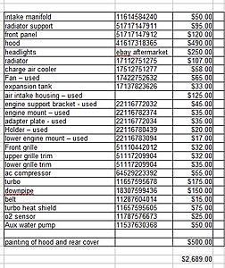

Here's the current parts list if anyone is interested:
Attached Thumbnails Picked up a bruised '14 today, here goes the rebuild-parts-list.jpg

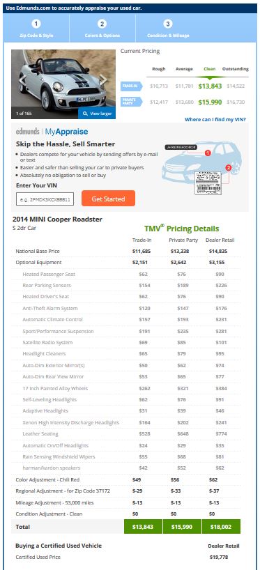

According to RealOEM.com, the hood is the same as the '12 R56, which is the donor. I did find out today while swapping parts that I'll need an AC hose, and the cowls, since the R56's are different.
As for profitability, this one is more for experience and fun than profit. It's winter and I'd rather wrench than waste away on the couch.
The '14 R59 in clean condition, 52K miles, and with a clear title in Nashville it is currently selling for around 15K private party and 18K at the dealer according to Edmunds.
Attached Thumbnails Picked up a bruised '14 today, here goes the rebuild-edmunds-value.jpg
