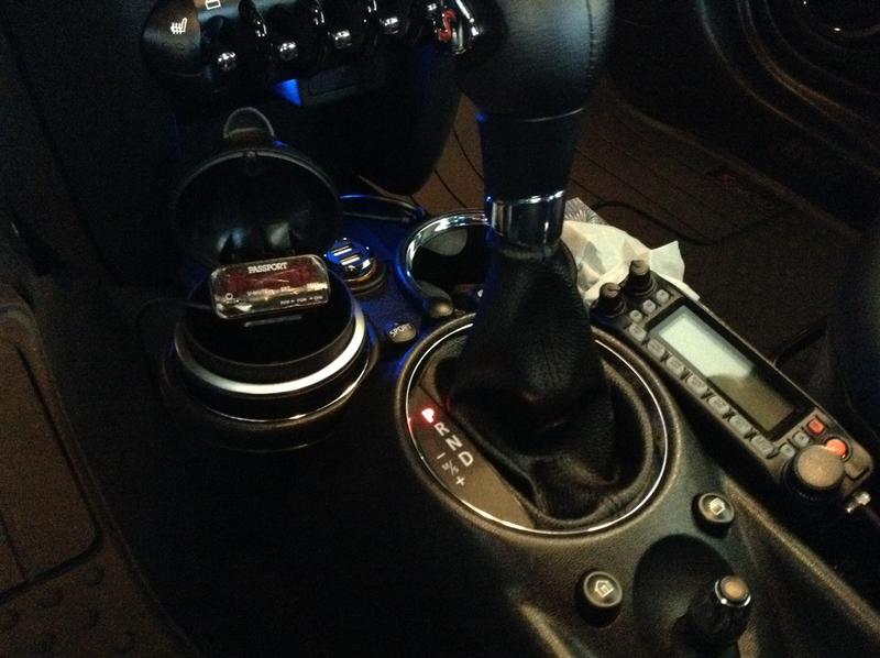

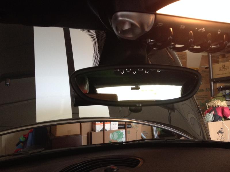

Here are a few pictures of the installed options of the Blackvue and hidden radar detector. Note the radar is mounted in the ashtray. The Blackvue is behind the mirror and if you look in the mirror you can see the rear unit in the back window.
A few more pictures

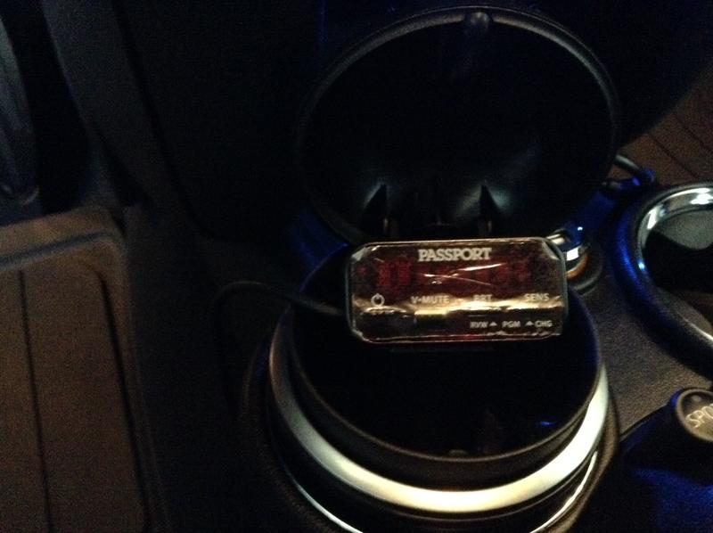

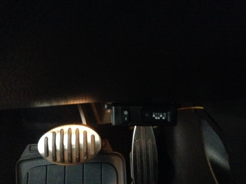

Better pictures of the radar in ashtray, note film not yet removed from face. Amateur radio is next to console on a gooseneck device that is mounted under passenger seat post. The black box above the gas peddle is the Magic Power Pro. Turns off Blackvue when battery drains to a specified level. Works in parking mode to record movement around the car front and rear. The ashtray is a Mini Ashtray and open has a nice flat surface that with some velcro the unit head sticks to perfectly.

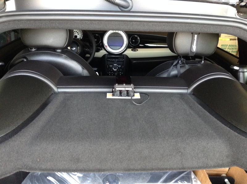

Here is the antenna for the radar detector. Mounted in the back between the seats. Straight shot out the front windshield. I did not want to risk a low mount near the bottom of the front spoiler. I need to add some rubber feet on the rear for a permanent install. A little velcro holds the front in place. All the parts to the radar can be moved easily if there is a problem. Unit is the 8500CI Escort. I did not need the Plus unit. And at eye level it really is a straight shot out the windshield.

I had to stick the Dash Cams on the glass and used what came with them. I could remove them and buy more sticky squares from Blackvue. The hidden radar has a voice box that is high up beside the gas peddle. Hard to see but easy to hear. I used a piece of Velcro to keep it in place.
I picked up a few plastic feet. They stick on things and you get them at Home Depot like pads to put under furniture. I need a little something like black squares to put under the antenna in the center to level it.
The Amateur Radio Head unit is on a gooseneck device that is made for GPS units I got off Amazon. Works very well with multiple holes in back for anything. I did need to buy a Torx set to loosen the seat as it clips under the seat on the passenger side. The seat rail.
I spent hours looking for a place to mount the radar display. Was thinking either high over the light that says passenger air bag off above rear view mirror but then notice that flat spot in the Mini Ashtray that actually came with my wife's Countryman. The ashtray flat spot was perfect, but with any install don't make anything permanent until some drive time to make sure you like it and move things around if needed.
The Blackvue surprised me. It has its own built in Wifi. So from my iTouch I press a button and link to its Wifi and download videos on the spot. Wave my hand on the left hand side of the mirror to turn audio recording off as recording both take more space, "But please turn it on if stopped by police to record all audio"!

Blackvue hooks up to the Magic Power Pro box above the gas peddle. Its purpose with the flip switches is to cut power when the battery reaches a certain level so you don't come back to a dead car battery as it will record movement and audio if triggered when your car is parked. You set all this up on your iTouch or iPhone or other device. And you can set time limits as well, 12, 24, 36 hours to forever.

Patience and the right tools these are not hard to install. I tapped into the fuse box on the passenger side. Used a multi-meter to find which fuses are always hot and which ones cut off. Just wrapped the wire around the fuse and put them back in. No fancy adapters. Trial and error but it works. Blackvue works when car is off. The radar comes on when I start the car and shuts off when I turn the car off. Simple.
