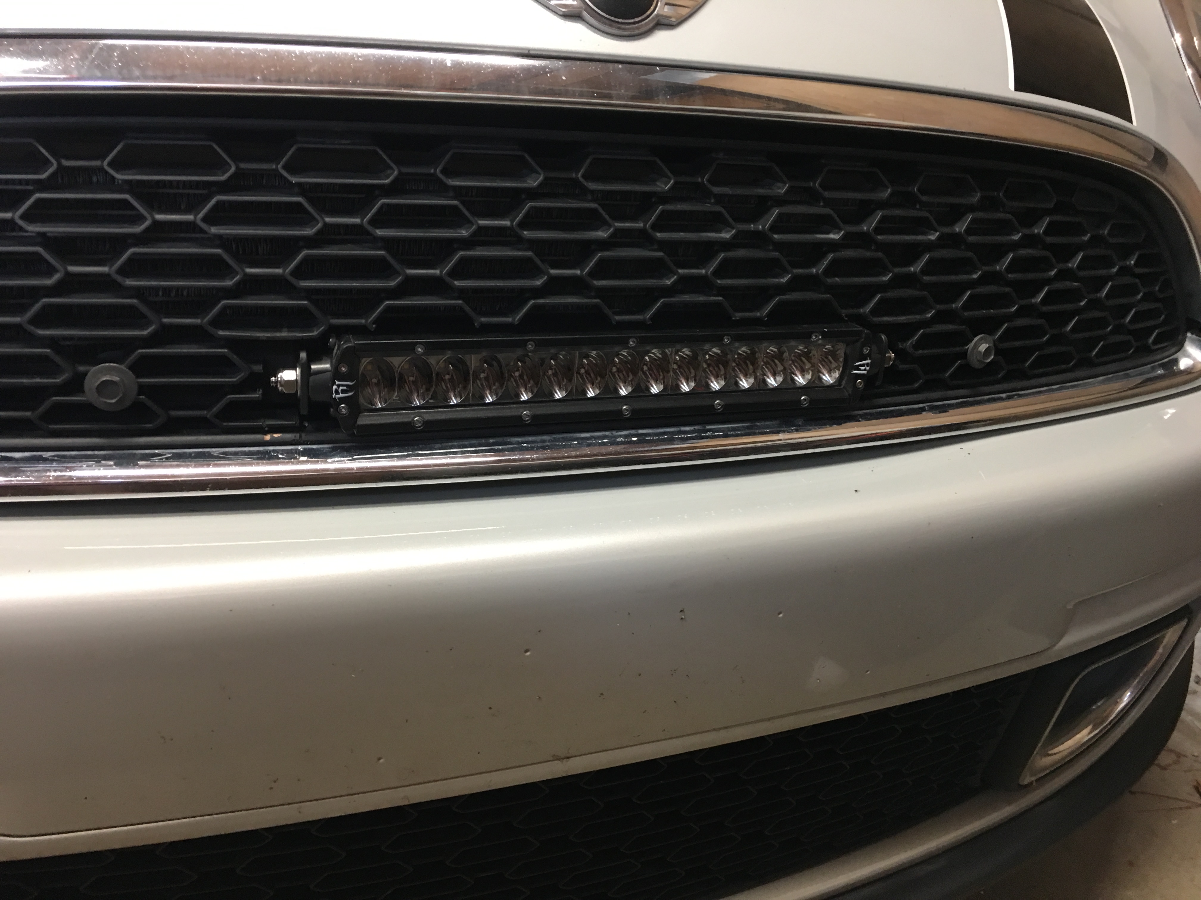

added LED lightbar to front grill
I added a Rigid Industries LED lightbar to my front grill and wired it to come on with the high beams. I used a Fein oscillating saw to cut the plastic grill and used the taller metal mounts turned sideways to attach it to the grill.

How big a deal was it to do this? I would actually have the dealer install it as I am a mechanical idiot. Is it that much of an improvement?

any idea of Lumen output ?

Awesome high beams
it makes a massive improvement to the high beams. The model is Rigid Industries 91061 SR-Series.

This is exactly what I'd like to do except I'm hiding it behind the grill.
Can you explain the wiring? Does power come from headlights or direct from battery? I test wired my light bar with power from the battery today and I fried my FRM which is now being replaced for something like $600.
Howdoes it only come on with high beams? Any chance of pictures of the wiring?

nice clean installation. Good job
