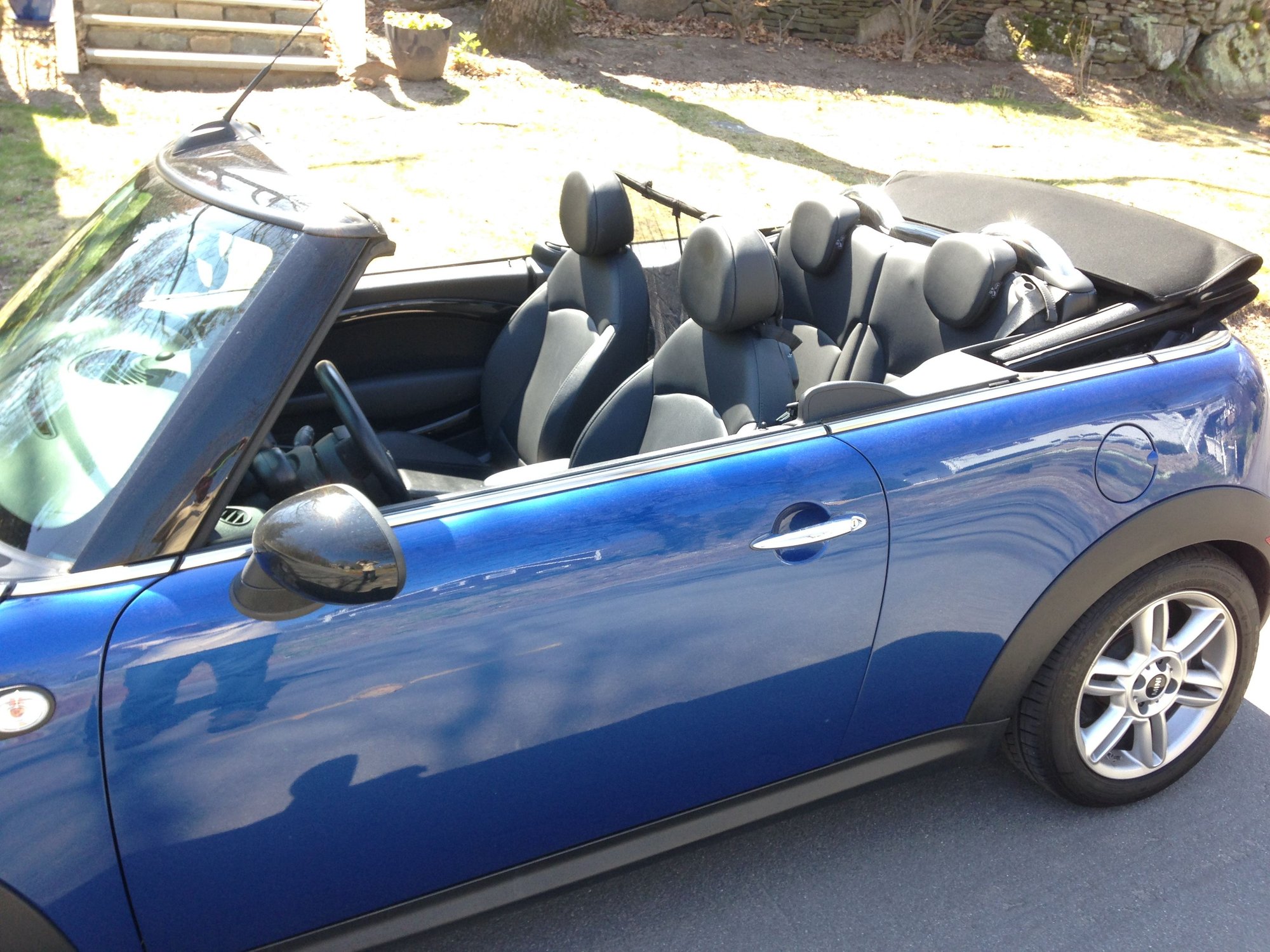

Sharing this here as a 'brilliant' solution to buffeting wind in the vert. It's in quotes because I'm not exactly sure yet that it's a great solution. But I'll update you when I find out later today.
The product I bought was via the Petco Website. It's a Solvit™ Sta-Put™ Cargo Area Net Pet Barrier.
The mesh screen has tie-downs and buckles and also a stick stay for the middle. It folds away the same way a photo reflector or a sunscreen does, by twisting it and stuffing it into the bag it comes with. Essentially it's spring-loaded and folds flat when you twist it correctly.
Unfolded the net is 36" by 22" - a big rectangle. And the advertising/marketing copy on the box boasts that it's clawproof micro-mesh netting.
While the photo and installation instructions tell you to put it in one way, I'm flipping it 180 degrees so the attaching points and straps are at the top 1/3 of the screen instead of at the bottom 1/3. I want to make sure the screen sits snugly in front of the rear seats and is attached to the headrests with only about six inches above the bar of the headrests. This way the entire screen will sit flush with the top of the headrests and not stick way up in the air.
There is also an attachment that is supposed to slip between the slot in an SUV bench seat. But since the bucket seats have a large gap between them, I think I'm going to just unhook that strap and see if the screen stays put without it.
I'll be back shortly. I took a photo of the box. Here that is...
Back shortly. *This cost me $17 total while the official wind deflector costs around $400.
Jeff

It is AWESOME. Though I can't compare it to the $400 version. But it has completely deadened the wind. I installed it in seven minutes and then blasted around town for five minutes to see how fast I could go and what wind would buffet me.
Very light wind. Much less noise. I think we have a winner.
Here are photos from the install just now. Hit me up with questions if you'd like. If there's an award for MINI Frugal Ingenuity, please nominate me.
Thanks!
Jeff
