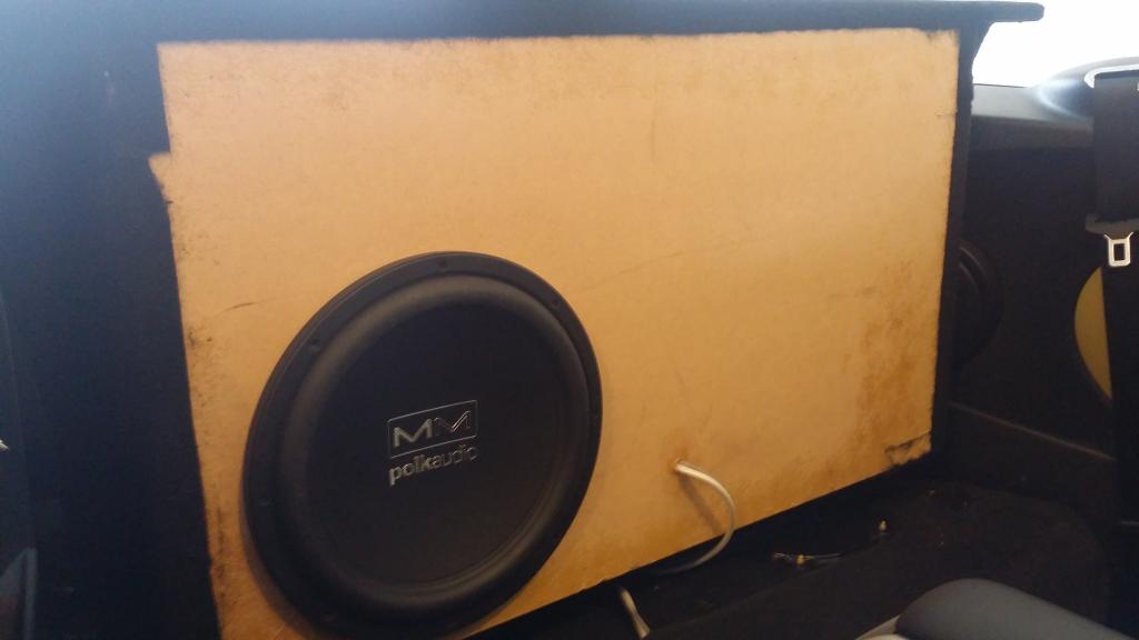

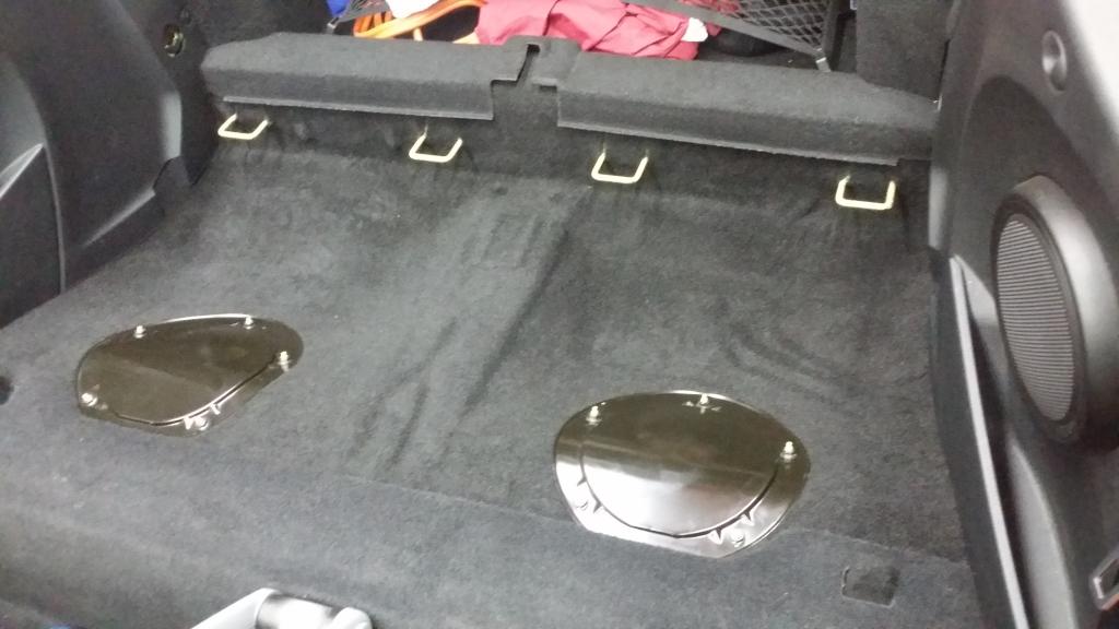

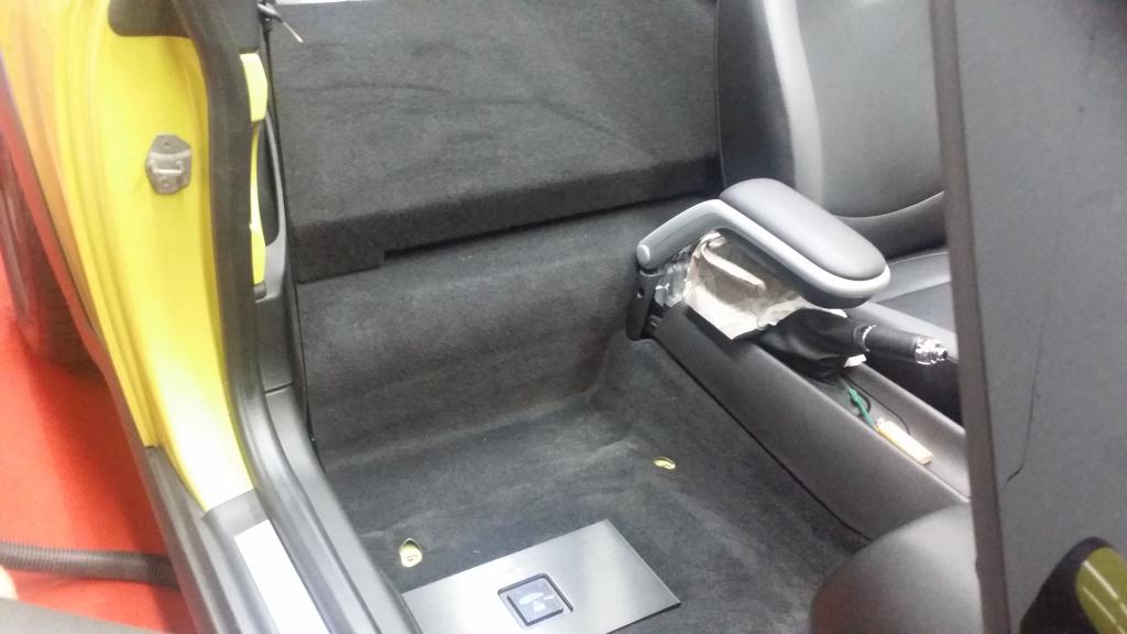

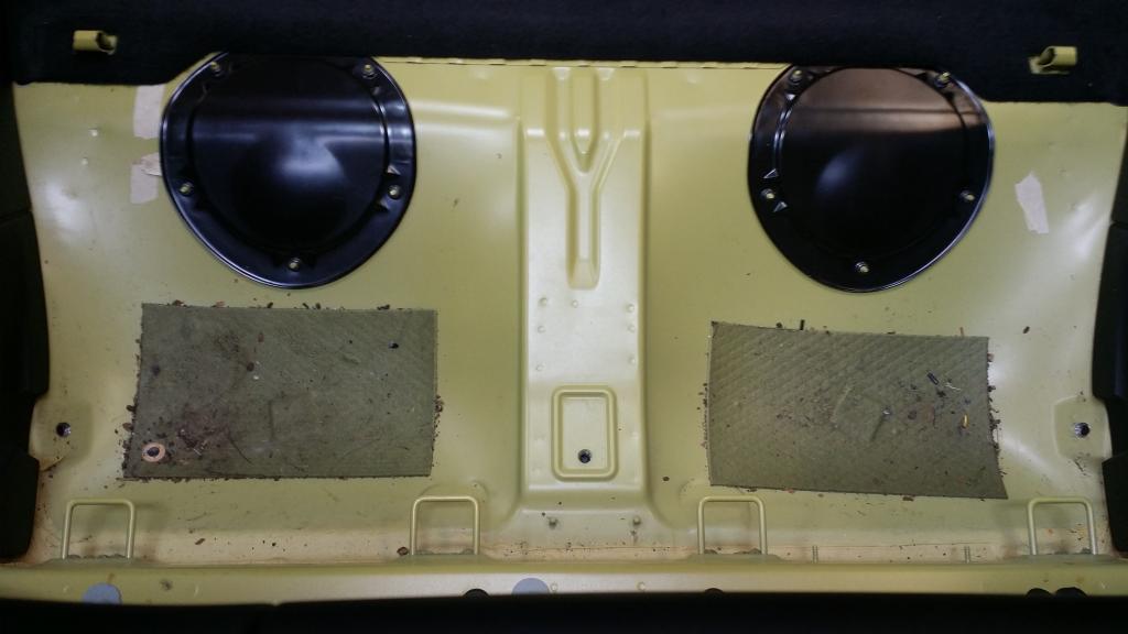

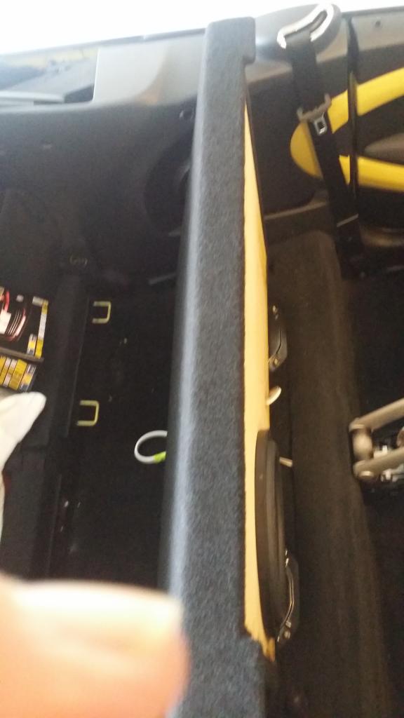

Finally finished my custom audio system. Rear seat delete with custom stealth downfiring sub box,amp in gps cubby under passenger seat e/ Polk MM1240DVC, Pioneer 9600 deck, Polk MM6501 in front doors, Polk MM651 in the rear qtrs, Arc Audio 5 channel 850 watt amp Xdi850.5. Since the polks are 2ohm I am getting 125w per channel and 400w to the sub....Sounde F'n killer Also dynamated the car and carpeted wear the rear seat used to be since its just bare metal under the seat.
Not the best pics
