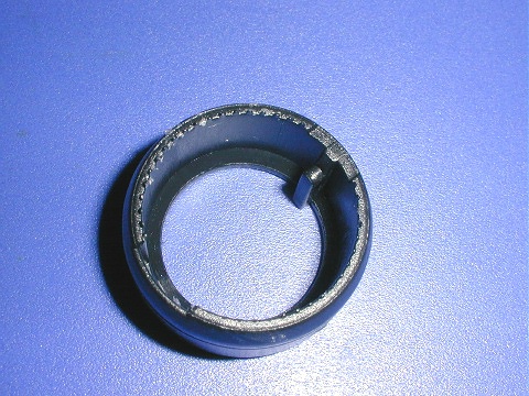

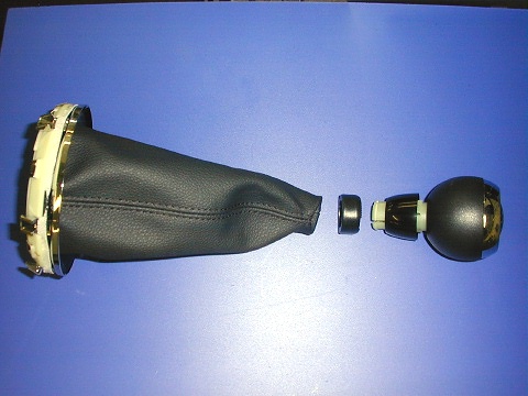

Here's the scoop on the R56 shift **** story.
The ***** are no longer a "separate" piece; MINI has gone to a one-piece ****/boot/trim ring assembly.
That said, the **** CAN be removed from the boot; it simply snaps into place, and can be pulled off.
The boot material folds over this small plastic small ring, and the stem underneath the shift **** snaps into the ring.
In addition to going to the ****/boot/ring assembly, they have also lengthened the distance from the top of the lever to the locking groove, which means a pre-07 **** will not fit an 07 car properly, and vice-versa.
The GOOD news (for me, anyway) is that new dimension on the shift lever is the same dimension on BMW shift levers.
For me, that means that the attachment mechanisms I make for BMW ***** will also fit 2007 MINIs; so I don't really have to do anything new.
The only thing that remains in question about the **** fitment on an R56 is whether, after the stock shift **** is removed, the boot will stand up on its own. The material may not be stiff enough.
I just shipped a **** to an R56 owner today. I'll know a lot more after he receives it and tries it out for a few days.
I'm thinking that the worst-case scenario is that I'll have to make some sort of collar to fit up inside the boot and hold it up against the bottom of the ****.
I'd make it from Delrin or another type of plastic, held in place on the shift lever with a set screw.

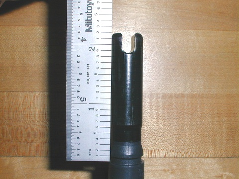

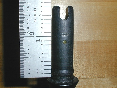

Here is a comparison of the two different shift levers, to illustrate why a pre-07 **** will not fit properly on an 07 lever.
Attached Thumbnails GRILL BADGE FOR O7-pre-2007-mini-lever.jpg   GRILL BADGE FOR O7-2007-mini-lever.jpg

Which is which? Is the tall one the 2007 lever?

Sorry; too much on my mind, and not enough mind.
Yes, the tall one is the 2007.
The dimension that they changed to is the same for all BMW shift levers.
Who knows? Maybe next year, the design engineers will switch it back.
