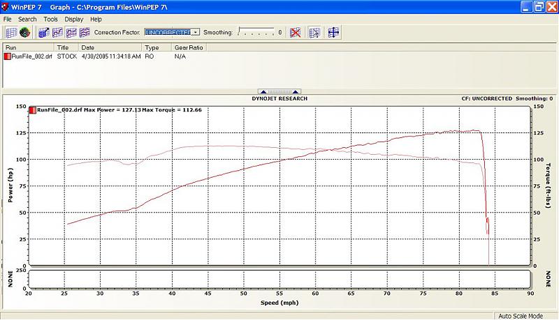

um after spending many years on my cobra, I grasp the concept of
SAE versus STD. SAE actually generates a lower number and is usually why its a lower number.
The uncorrected number is STD. so for example my car produces over 700STD but only 680SAE (which is the corrected number based on altitude
and temperature).
so I dont think the 209SAE is being missed, and since it is a corrected number it seems really high for a stock R56.
altitude generally has a negative effect(at least on supercharged cars) so a car like my cobra will actually generate even lower HP numbers when dynoed
at a higer altitude like denver.(corrected or uncorrected the numbers are lower).
so the point still stands 209SAE is well beyond the variance I would expect from a stock 172hp R56, corrected, thats a high number.
now if it said 209STD then I would say ah, thats understandable and makes sense. but since you keep insisting is SAE, then it doesnt make any sense.

At altitude:
Here is a stock 2005 Cooper S (supercharger) SAE corrected and uncorrected at the wheel. Roughly, 10-12% drivetrain compensation puts the SAE number right where MINI quotes crank horsepower for the 2005.
The great thing about the 2007 is it seems to be achieving the MINI published numbers at the wheel instead of the crank!
I forsee the 2007 having a descrepancy at altitude between SAE corrected and uncorrected, just to a lesser degree due to turbo effeciency.
I'll dyno (same dyno, same altitude) my 2007 soon to find out. Speculation only goes so far.
Btw- When I plug in STD to the graph it is similar to SAE numbers but "uncorrected" is much lower than than both STD or SAE...?
Attached Thumbnails MCS 0-60 in 5.7s???-sae-stock-2005.jpg   MCS 0-60 in 5.7s???-uncorrected-stock-2005.jpg
