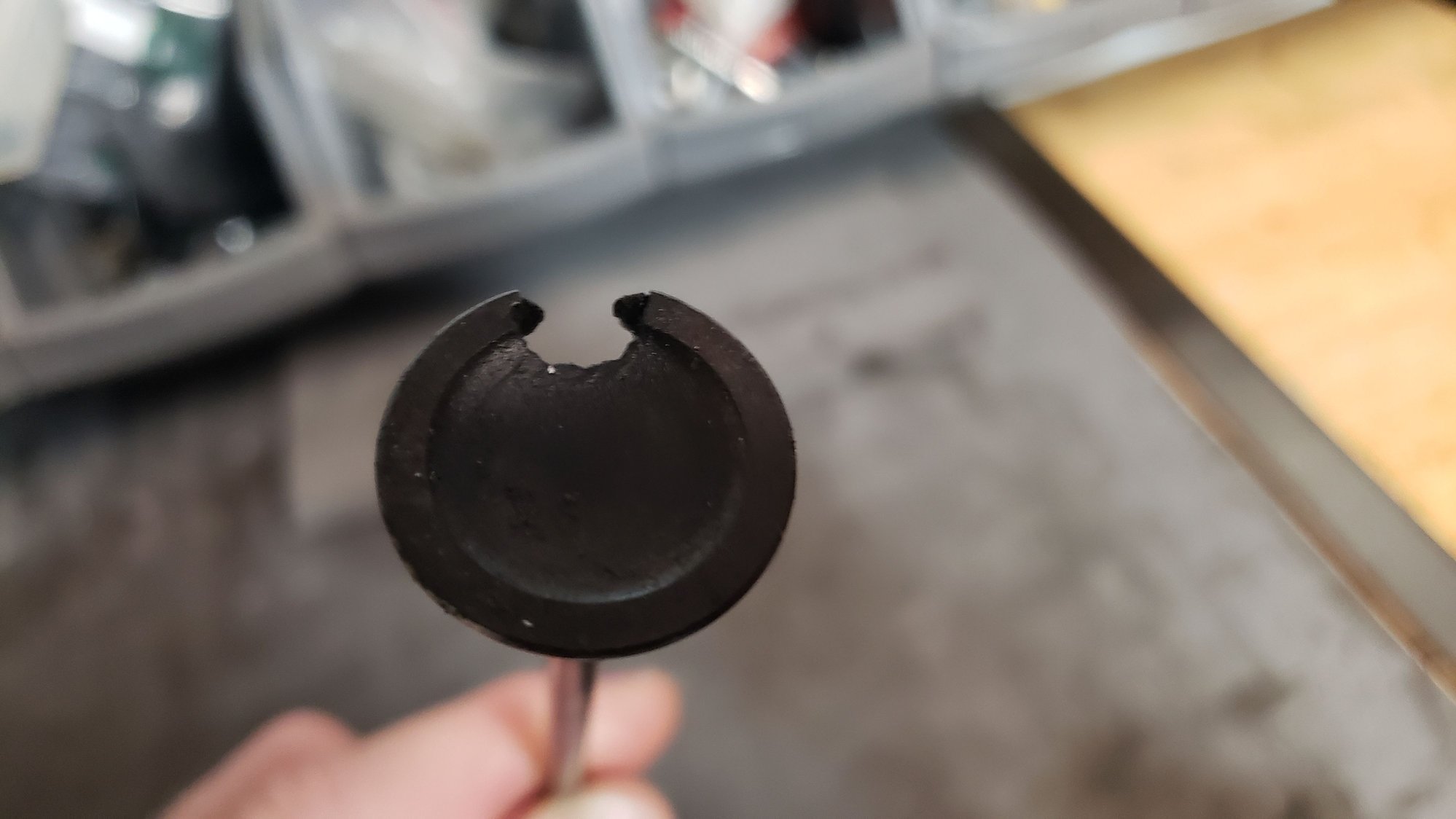

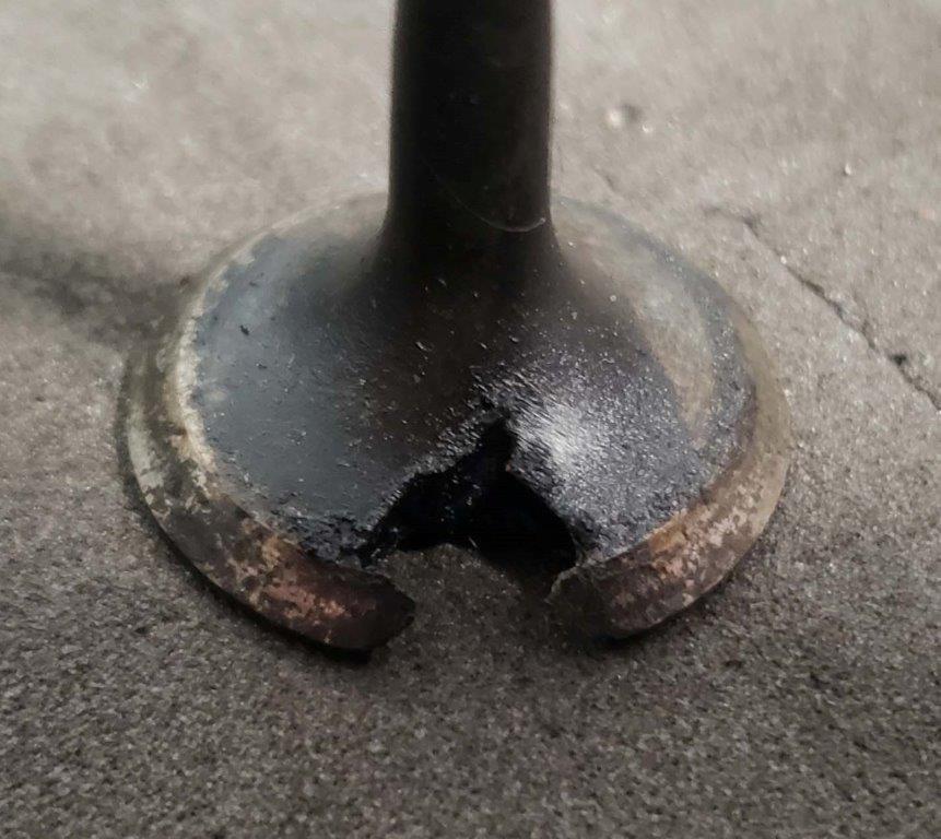

Concur with Adam.
To the main issue: No compression in cylinder 2. I've worked on a lot of Gen 2 MINIs, The biggest problem I've seen with no compression in a cylinder is burnt exhaust valves. These engines tend to drop valve seats too. I've also see the valve seats drop, break into pieces and get munched by the piston. Either way, the shop that performed the diagnostic deserves to get paid for their time ... even when it's bad news. You'll need to perform a leak-down test next to see where the air is escaping from cylinder 2. Bad news is you're probably going to need some major engine work to get you back up and running.
