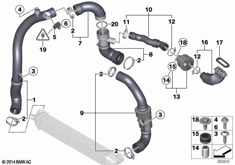

My guess is that the charge air temp sensor fault is causing your misfires. Replace the sensor, and see what happens.
Part number 13627599906. Item #5 in this diagram:
