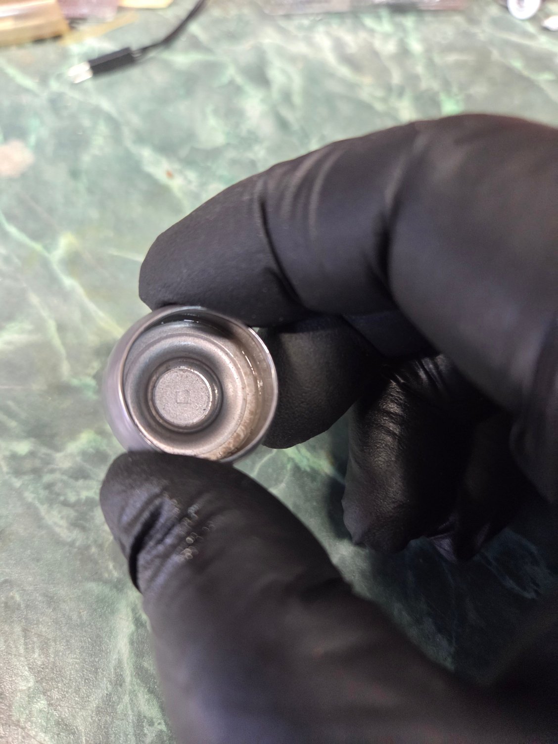

Found in oil pan
Hello, after asking 2 techs at local mini dealer they had no answer, so im trying here and im sure someone knows the answer...
this was inside my oil pan. Found it during a routine oil change and noticed the draining oil was blocked..investigated and removed the oil pan and this was what i found...what is it and where did it come from..car is a 2013 mini cooper base auto non turbo...it is metal and feels powdercoated..

Looks like the rear main bind plug.
Part #4 (blind plug) in RealOEM diagram, but unfortunately exact location is not indicated.
But in a different thread, lex2008 showed the location.
