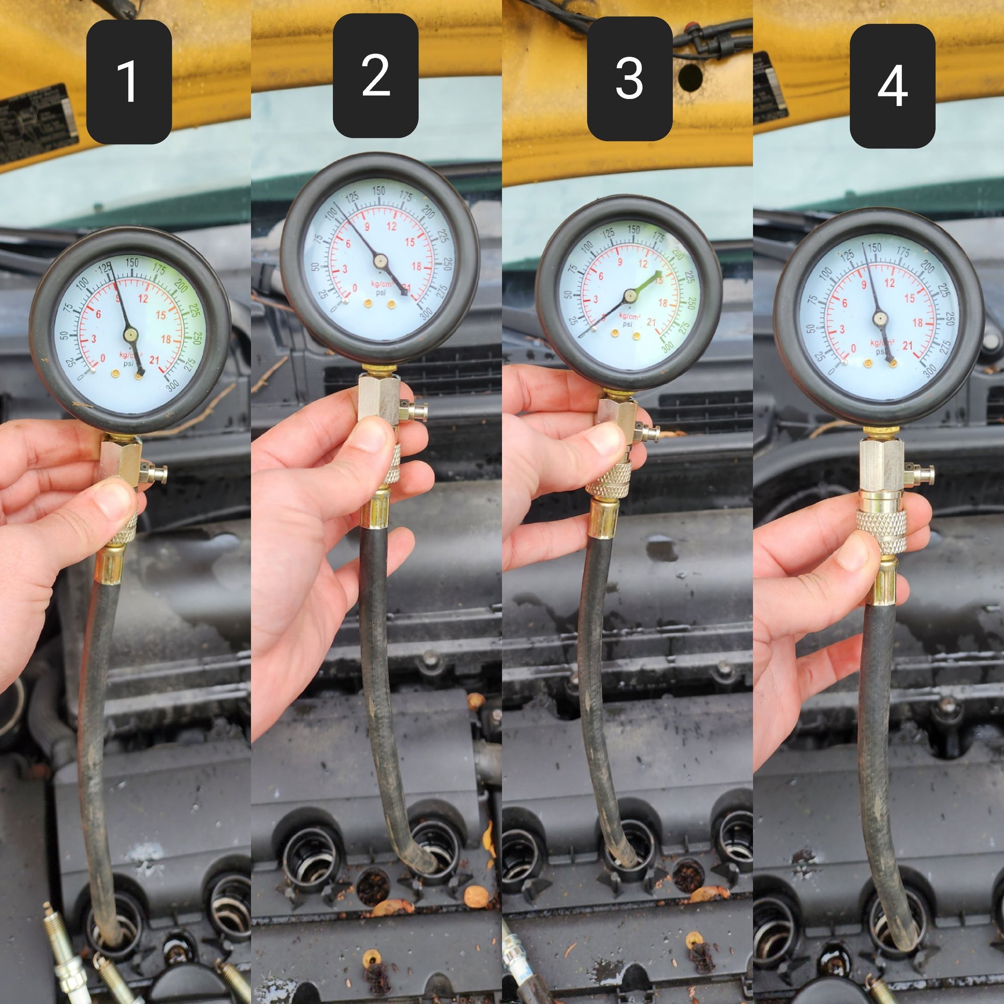

Thanks for the reply, I did put new spark plugs in, but that did not fix anything.
I then did a compression test...

No maintenance on that engine! Those plugs look horrible ... may be original. Need a leakdown test to see what the leak-down is for each cylinder and to find out where the air is leaking out.
