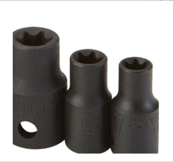

@BigDog9721 ,
I'd use an E-Torx socket. I haven't seen any thin wall deep sockets in my life. Otherwise every socket would crack due to thinness
E-Torx socket

Well actually a 10 mm long socket did the trick, the E6 torx did loosen it up but i really don't know what that one does... I was able to pull the a/c line and order a new one... hopefully my a/c will be back in order just in time for winter! LOL!

Yoshimura-1, I'm glad i have the e-torx sockets... .I'm just not sure what the E6 connection to that a/c line on top of the 10mm bolt does.... any ideas?
