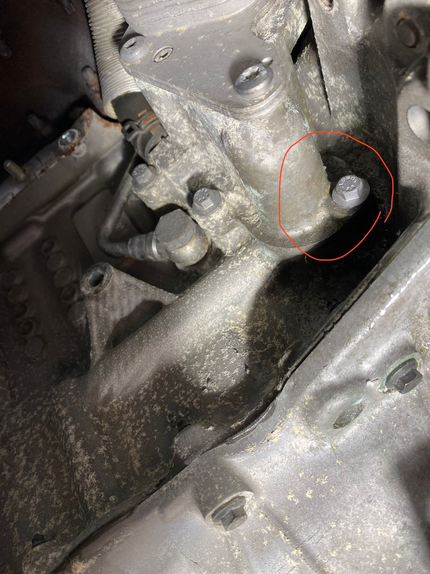

Ok, I think you’re onto something. After removing the inner heat shield, the leak “seems” to be coming from right where the circled bolt is (oil filter adapter?). Seems dry above, but I don’t have much access.
Yup, that is exactly where I am referring to. There is a large o-ring type affair, shaped like the oil and water passages, between that adaptor and the block, and another one between the two halves of the heat exchanger/oil filter adaptor, which is held together by those torx bolts. I used MINI factory parts there, as well as everywhere else when I did my head gasket. I did also install the Detroit Tuned turbo line kit, and it is very nice and well made. I highly recommend that, or at least new factory turbo lines, or else you will likely be right back in there soon.
