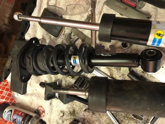

I have an 09 with almost 150K on it. I would recommend doing the cooling system: Hoses, t-stat and housing, water pump and pipe. Also the crank seal should be done with the timing chain. A few of my coils have gone out too. I would replace those and the valve cover gasket as these are common failure points if they have not already been replaced. Change the trans oil.
I am replacing all four shocks/struts too. I thought they were on their way out but after removing have learned they were toast! No leaks but also no piston pressure or rebound at all. (Pic below) I think you need to remove some suspension components to remove the trans. Might be worth it to do front struts too.
