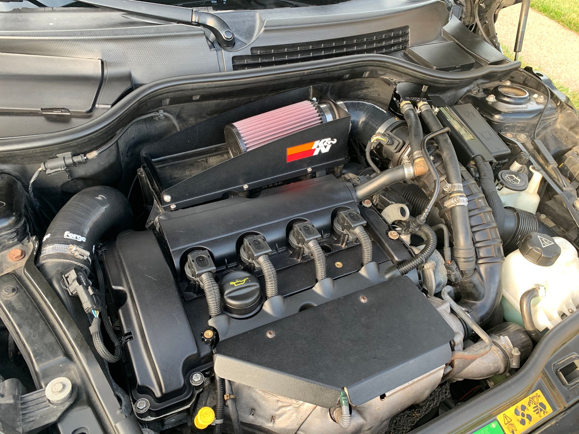

Ok all up and running, I used the Carista app to check for codes since the torque app did not show any.
it cost 10 bucks but i feel it was worth it, Carista scanned everything and showed 40 codes, i read through them and there were odd ones like speed sensor and such. so i cleared all of them the only one that has stayed is the dreaded airbag light and code for the passenger seat sensor.
that i will hopefully take care of with NCS expert later.
After clearing al the codes and letting it warm up and moving it around no codes cam back other than the airbag. So far so good.
i have added the catch can but need to get the correct clamps for the hoses, and am cleaning the factory airbox but decided to play around with the air cleaner.
the factory air box will be reinstalled once i have it good and clean. so next is a fresh oil change and if the weather gets better a test drive.
thanks everyone for the input.
Old Feb 7, 2021 | 09:34 AM
  #36
Lex2008's Avatar
Lex2008
Joined: Nov 2014
Posts: 1,784
Likes: 197
Awesome bro. Those non cool air intakes crack me up!
I like your turbo shield. Is that real diamond plate?

Yeah, I always wonder about the physics there. The filter element of the stock airbox is huge - wouldn't be surprised is the area is even bigger than those cone filters. And the fresh air supply routing has roughly the same diameter as the intake-to-turbo piping... But I can see the butt-dyno argument.

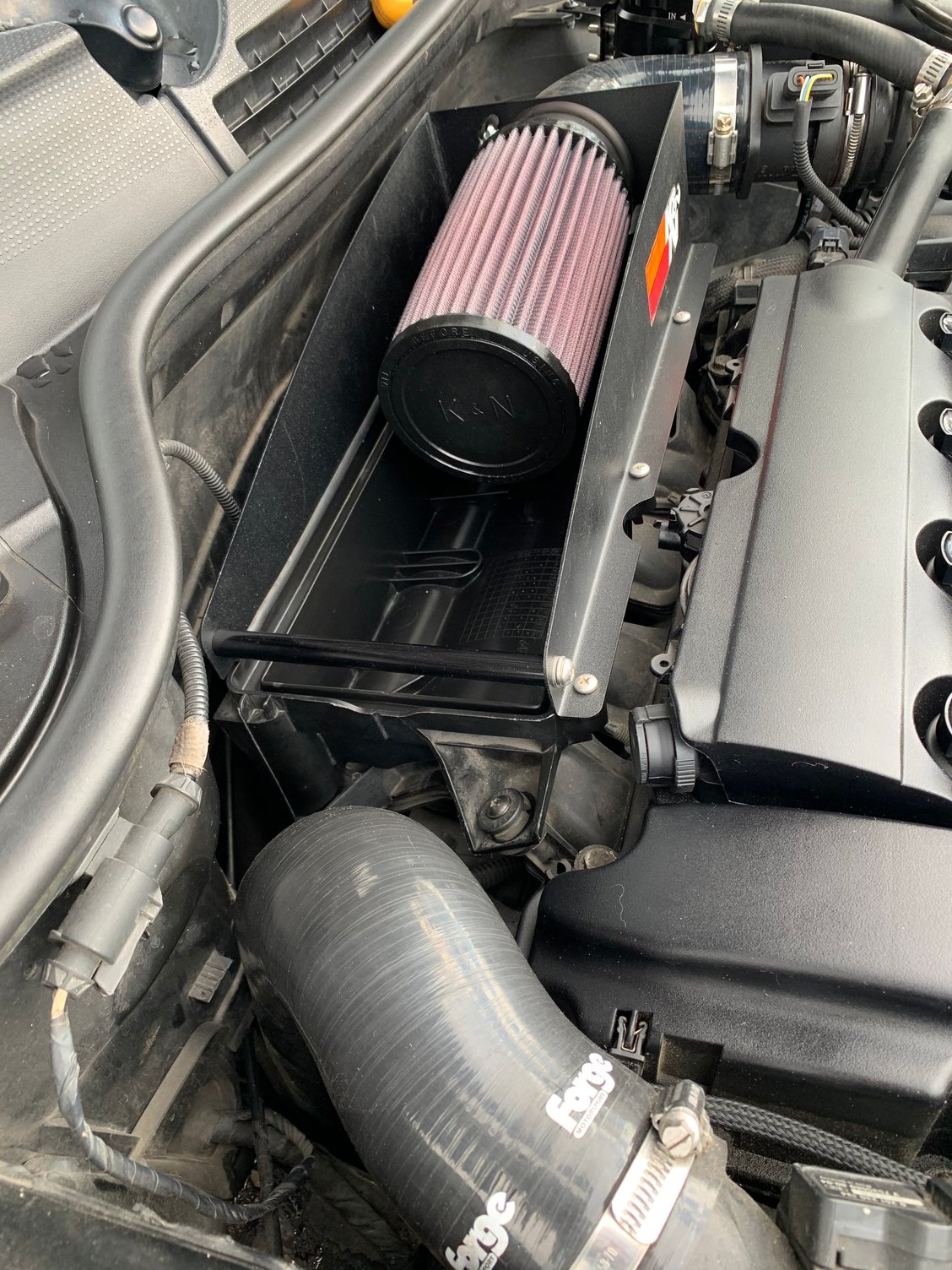

This was just stuck together to be able to run it while the factory airbox is drying. other than being clamped on it is just hanging there no mount anywhere.
It is only about 50 in my garage and the airbox overall is drying ok but the lower section has all these nooks and cranny's that are not drying very quickly and I was getting restless and did not want to run it without any filter.
This filter is actually off my F150 I traded in a few months ago. I was surprised I had a bunch of parts laying around to stick it on there. but I would not drive it around like this lol
Old Feb 7, 2021 | 10:46 AM
  #39
Jason Cornelius's Avatar
Jason Cornelius
Joined: Dec 2019
Posts: 2,107
Likes: 691
From: Cincinnati, OH
you actually should be able to drive it around like that, you intake temp will go up, but you should be fine. This is a DDMWorks street intake, basically same thing you got going on, just make sure hose clamps are tight.
Considering how expensive those hot air intakes are, you're better off spending that on a bigger turbo....

It was a kit with a 4 inch tube and the filter has a 4 inch inlet, is was from a 2010 with the 5.4. i never had any issues with it on the F150 after it was installed it had better throttle response and the gas mileage went up slightly plus when you got on it you could hear it lol.
it was made to fit just inside the lower factory airbox and had a new metal upper airbox.
