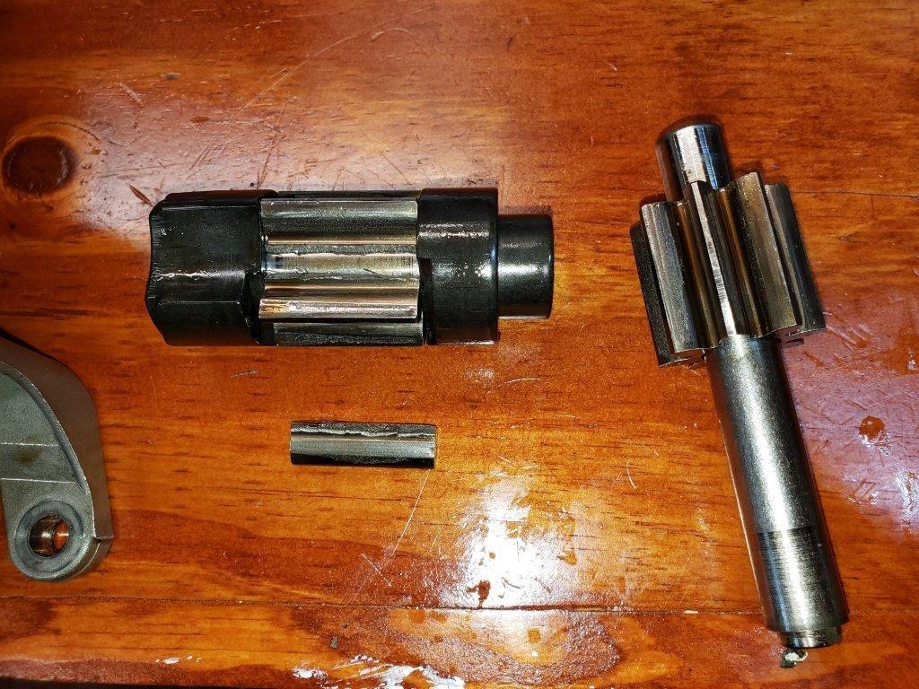

Removed oil pump after noticing the bolt had sheared off. Thought it was kinda odd. Upon further investigation found that the pump only rotates about 95% before coming to a dead stop. Removed the case front and the gears look fine. Am I missing something?

Figured it out. Tooth on the gear broke. Looks like I need a new pump
