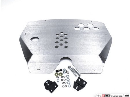

No, its not that low unless you have huge speed bumps/ in LA or NYC with bad roads. I really lowered on coilovers and I am fine. Some people that are slammed on coilovers or on air lift will have issues, but when you do that you know what you are getting into.
The biggest issue are actual rocks on the road and roadkill that might bump the lower front bumper and the pressure lip under the bumper. If you worry, just get a skidplate.
https://www.ecstuning.com/b-rennline...plate/u03~rel/
