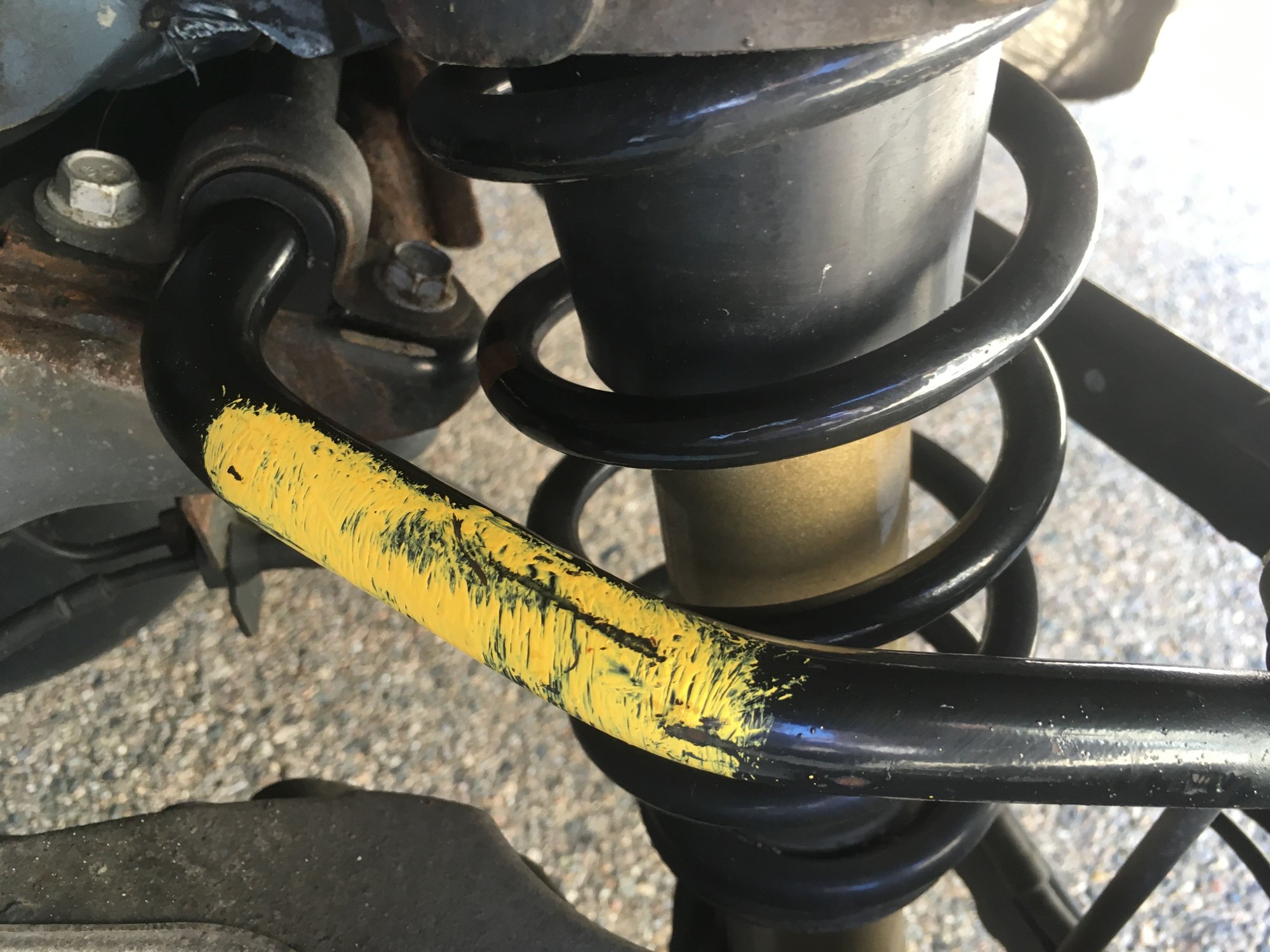

According to the dealer, this is the rear JCW sway bar retrofit that is 18.5 mm. What is the purpose of the yellow paint marker? I have seen automotive springs with different color dots to classify spring rate before- but never on a sway bar!

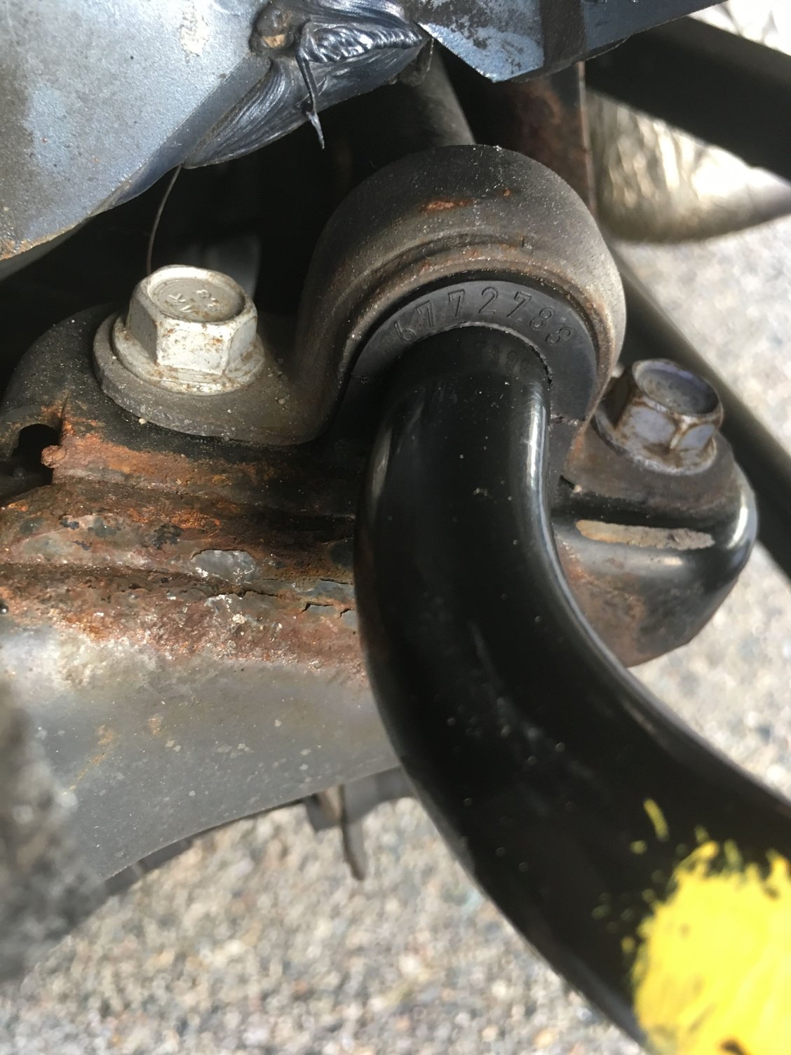

Included is also a picture of the rear bushing. This only has 9,000 miles ( bar,bushing, links, spring and shock)- but the deflection of the bushing seems a lot. I am told repeatedly that “ they all do this”. Pity about the black paint falling off- time to get under there with some chassis black paint before winter and clean that up.
1. What is the yellow marking paint?
2. Do all RSB bushings deflect this way and eventually cause clicking or noise?

Dealer supplied bushing. Ouch that rust! Must clean that up and repaint with chassis black before winter!
BMW paint marking on RSB! Why?

There is nothing wrong with your bushings. They are supposed to deflect.

Yep, on that one side it has yellow paint, i just think that the way they noted it. 33500429708

Thanks for posting that link. At first glance under the car, I thought that the bar was rubbing on something!! Glad to see that all the rear JCW 18.5 mm rear bars look that way. What is your opinion on the bar bushings in the pics I posted? Can that amount of deflection be eliminated with a different console bracket, or the brackets that have the zirk fittings?

Welcome. That looks normal for the bigger bar. Think it sets tight. If you get a different bushing it would have to be bigger with a larger bracket. I dont think the deflection is that much of an issue. With poly, it would be a little tighter as the stock bushing have give.

I see the bracket with zirk fitting and bushing options for the 19 and 25 mm bars. IS there an updated version for the 18.5 mm factory bars?

MINI uses the 18mm bushing for the 18.5mm bar. I would use the poly 18mm bushing and give it a little grease.
