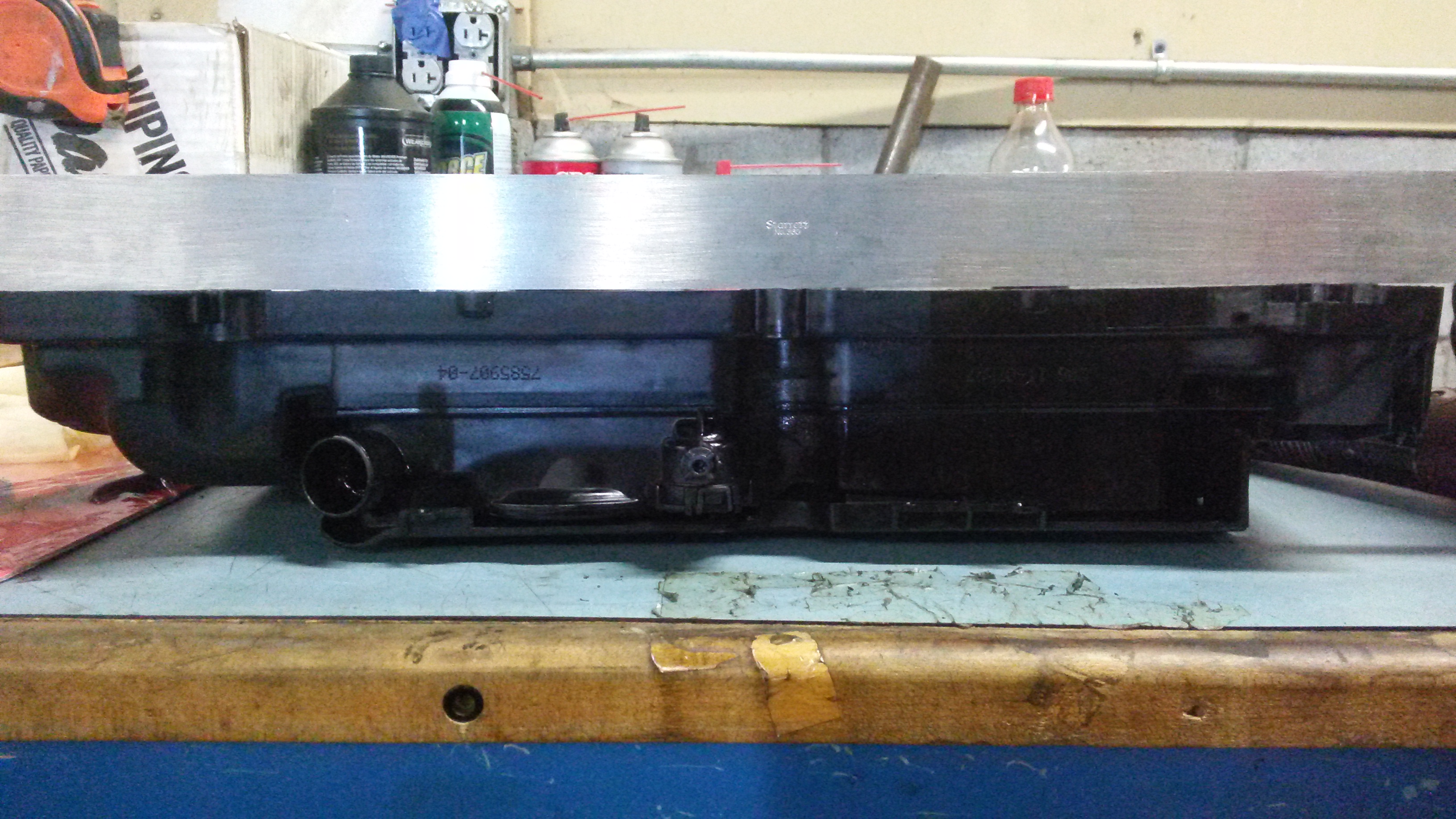

Thanks. Looks like the VC itself was warped. Unless anyone thinks this is a symptom of something more (excess heat etc) will just replace cover and gasket
