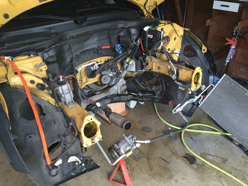

I did it with leaving the AC system connected. There's enough flex in the lines to pivot the condensor away. I held it away with bungee cords.
I pulled the engine straight out the front. I recommend pivoting the engine/trans about the transmission end.
Keep the AC compressor supported so it doesn't hang on the lines. Make sure you disconnect the alternator cabling. It's kind of hidden and attached to a channel on the passenger side of the bock.
