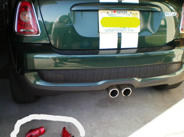

on a 2007, if you did not order the rear fogs there are black plugs in that rear grill where the lights would go. That's how mine came and I disliked the look that 'something was missing' in the grill altho the fact I did not have the function didn't bother me (don't get much fog in my part of Florida)
The light fixtures are inexpensive and install in about 90 seconds a side. That';s what I did, put the lenses in but never hooked anything up . . . could be yours is the same - if you don't have the switch ...
