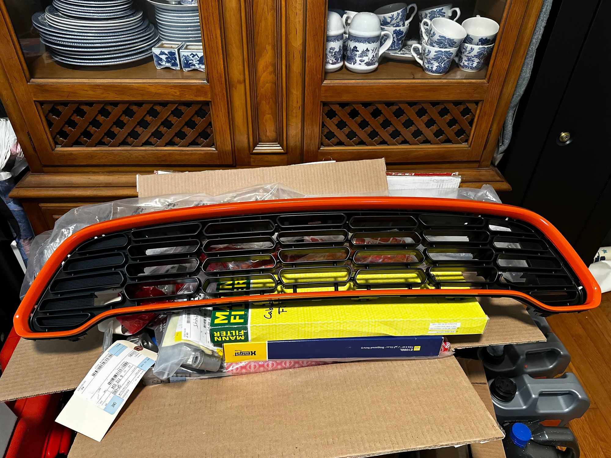

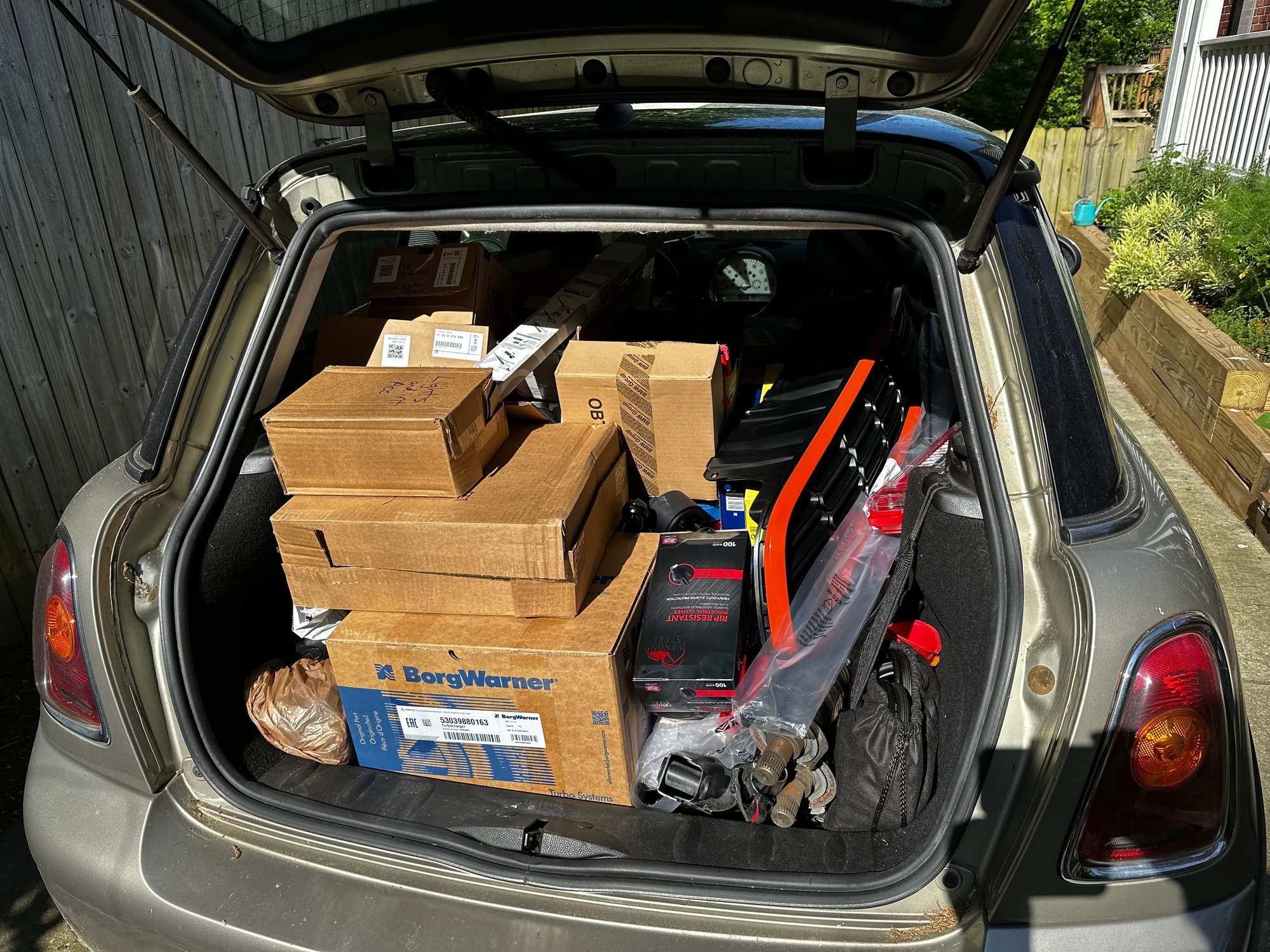

Ahh the fun of repairing suspension. Finally did all 4 corners on my R56 at 250k miles and decided it was worth it to buy a proper suspension press for the shop. Now I'm working on my R60 that spent a winter in WV with the previous owner and this is my current build list for next weekend:
✔️= already completed last weekend
Engine:
Lower engine mount bushings.
Hood catches.
Hood release cable.
✔️Vanos adjuster units.
✔️Ignition coils.
Oil pan bolts (stainless ARP).
Oil pump solenoid.
Oil pump bolts.
Oil pump chain.
Oil pump drive cog.
Oil pump crank cog.
✔️All coolant hoses.
✔️Coolant expansion tank.
Primary cooling fan.
✔️Front Main Seal.
Transfer box lock ring and plug seal.
✔️All Vacuum lines.
✔️Coolant turbo feed lines.
✔️Braided NM Oil feed lines.
✔️Vacuum pump.
✔️Vacuum tank.
✔️Vacuum regulator.
✔️Vacuum solenoid.
✔️Boost regulator.
✔️Engine mount.
✔️Engine mount adapter.
✔️Engine mount bracket upper.
✔️Timing chain
✔️Timing chain guides
✔️Vanos solenoids
✔️Oil cooler
✔️Oil filter housing
✔️Downpipe Heat shields
✔️Upstream o2 sensor
✔️Downstream o2 sensor
✔️Belt tensioner
✔️Friction wheel assembly
✔️Valve cover
✔️Spark plugs
✔️Engine ground strap
✔️Hot side charge cooler line
✔️Cold side charge cooler line
✔️Thermostat with housing
✔️Coolant hard pipe
✔️Water pump
✔️Dip stick tube
✔️Dip stick
✔️Clutch hard line
✔️Clutch master cylinder
✔️Clutch slave cylinder
✔️Turbo kit
Suspension:
Left front lower control arm
Right front lower control arm
Both front control arm bushings PowerFlex
Both control arm bushing mounts
Front sway bar bushings
Strut tower cross bar
Front ball joints
Front struts
Rear struts
Rear end:
✔️Rebuild new rear axles
Rear Differential full service
Rear diff bushings
Rear subframe diff/suspension carrier
Axle back borla exhaust
Rear Exhaust hangers
Front exhaust hangers
V-band clamps
Guibo
Both rear wheel hubs
Rear hub bolts
Lighting:
LED Rally lights
Rally Grille
✔️Headlight LED upgrade
✔️Fog light LED upgrade
✔️Daytime running light LED
trailer wiring
✔️Headlight mounting tabs
✔️Rally light wiring harness
Tail light circuit panels
Body and interior:
Window trim strip
Door emblems
Trunk emblems
Rear center seatbelt
✔️Swap rear captain seats for bench seats
Headliner re-mold
Brake duct pipes
Plasti-dipping the brake duct inlets to match pin striping and grill lipstick trim
Jack Pads
Front wiper blades
Rear wiper blade
✔️M7 hitch mount
✔️MINI OEM rear bumper bike rack
✔️MINI OEM roof rack cross bars
✔️MINI OEM roof box
✔️New set of tires
✔️New EBC slotted rotors and pads all round
