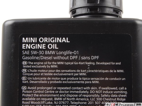

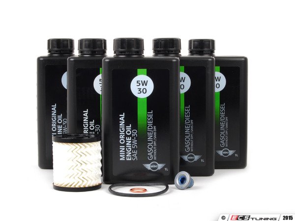

It will be fine, just get the 0-40w that meets the MINI LL-O1 :
http://www.ecstuning.com/Search/SiteSearch/11427622446/
We also have full oil change kits with the drain plug and crush washer also. The genuine MINI one is the same one used at your MINI dealership.
http://www.ecstuning.com/Search/SiteSearch/11427622446KT/
And we also have some aftermarkets that meet the MINI / BMW LL-01 standards. Its the ( European Formula ) version.
http://www.ecstuning.com/Search/SiteSearch/11427622446KT/ES2581338/

BMW / MINI LL-01 , its the company standard they use for Long Life oil. Search BMW LL-01 to learn more about it, its all over forums.
