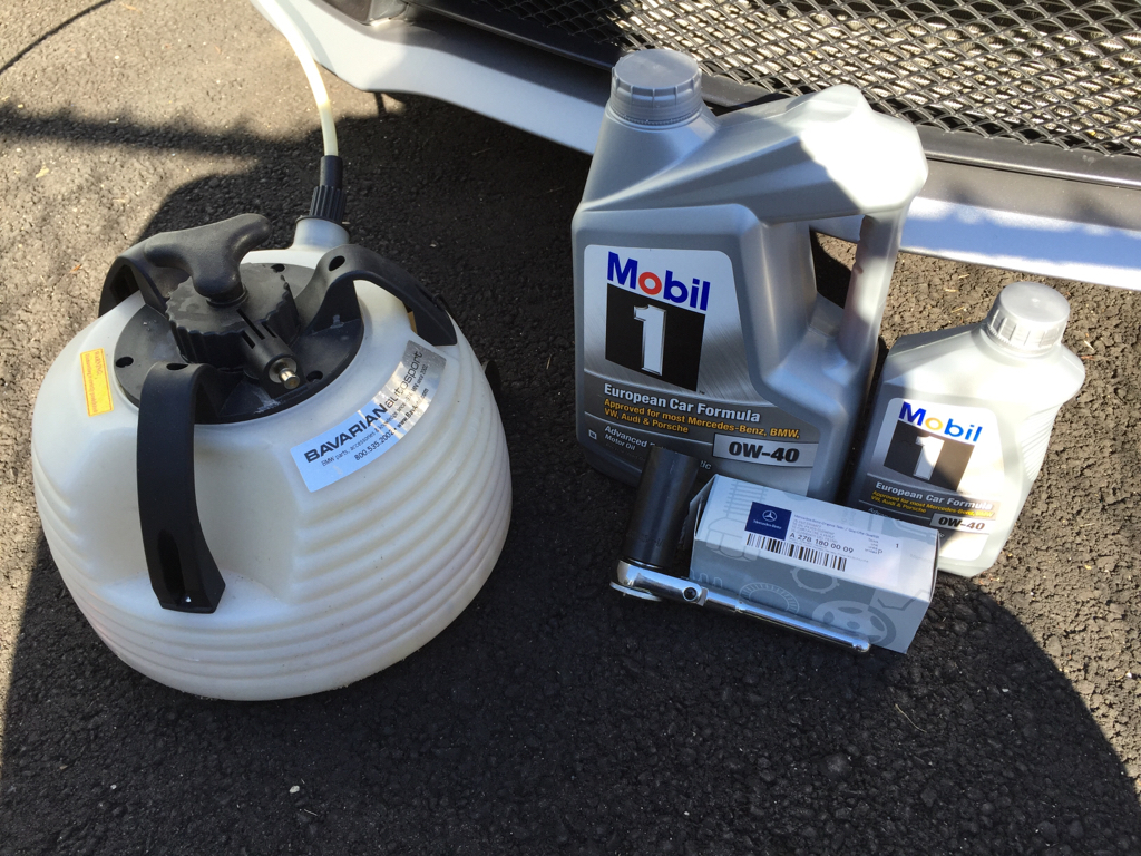

Originally Posted by bcriverjunky
I use an oil extractor. Easiest car I've ever done a oil change on.
I bought my mini at 25K miles and last weekend did my first oil service on it.
I used my Bavarian Autosport extractor and then pulled the drain plug - about 1 teaspoon of oil dripped out the drain, so next time I'll only go with the topside extractor only.
