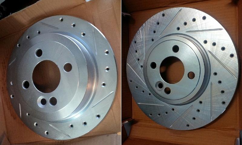

I have a 2010 Mayfair S (Limited Edition Hatchback). Hart Brakes sent me 4 brand new drilled and slotted rotors (2 front, 2 rear) for $144.00 including shipping to California....I installed them myself in about 3 hours using the jack that comes with the car in my 1 car garage...have 1,000 miles on them. Took 500 miles for the old used brake pads to seat and quit making funny noises (they had some miles on them (the pads) already. I do have a set of brand new pads ready to install now. I found the "Hart Brakes" rotors on Ebay (free shipping)

i got a set similar to those, mine are brake motive, they were about the same price with shipping as well
theyre nice quality
I havent installed mine yet, im lazy and the rotors on the car are not completely shot yet
once the rain stops and i get some jack stands i will swap mine out, i dont trust that little jack that came with the car...
get your tires and balance checked for the vibration, i had a used tire put on my car and it had a horrible vibration at first
i took it to a better tire shop and they said the weights were falling off and werent put on correctly from the last shop
you clicking noises could be the pads moving slightly in the calipers, some brake pad grease should make that stop
check those when you swap out the rotors
i dont know why they say the rotors are going to squeal, these cars have electronic wear sensors so they wont squeal when they wear out
my pads dont even have the wear tabs on them to make the noise

General suggestion is if you want quiet brakes....and judging by the op's rant, he does, you stick to PLAIN rotors and decent nonperformance pads....
Slotted rotors usually "whirr"... Drilled can crack...and both wear out the pads faster in most cases, making MORE DUST....
Most performance pads are a bit " harder" and will have a tendensy to squeel when cold, and for the first few thousands miles till they bed....
OEM pads tend to be the WORST as far as dust goes ...
A near dustless option that is a good street pad is Akenoobono euro pads.....not a track or "fast pad, but works for many...best installed on new rotors...
