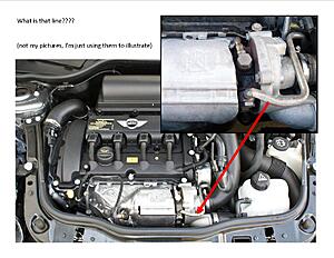

Hey,
What is that second line on the top of the turbo?
Mine is very rusty and might need to be replaced.

Coolant line.
#5 For the N14 engine you have pictured above. up to 2010 Cooper S / up to 2012 JCW
http://www.ecstuning.com/Search/SiteSearch/11537567849/
Dont forget the banjo bolt and washers if you do change it.
http://www.ecstuning.com/Search/SiteSearch/07119905973/ES2673307/
and
http://www.ecstuning.com/Search/SiteSearch/07119963201/ES2597254/ x 2
Most people change them due to the connection that goes to the bottom of the expansion tank, because they can leak there over time from oil changes and moving the expansion tank. That's the quick release end.
After replacement you will need to re-bleed the coolant for air in the system. At the top of the thermostat housing.
Top off with MINI coolant after replacement first.
http://www.ecstuning.com/Search/SiteSearch/82140031133/

Is that cut away ( smaller pic ) your actual MINI pic ? If so then yea the top oil line looks like its leaking.
Old May 4, 2015 | 07:56 AM
boatman2500's Avatar
boatman2500
Joined: Mar 2015
Posts: 8
Thanks for the great replies!
I'll be replacing both oil and coolant lines this summer.
The pictures I included aren't of my engine, they're just from a google search of the R56 N14.
