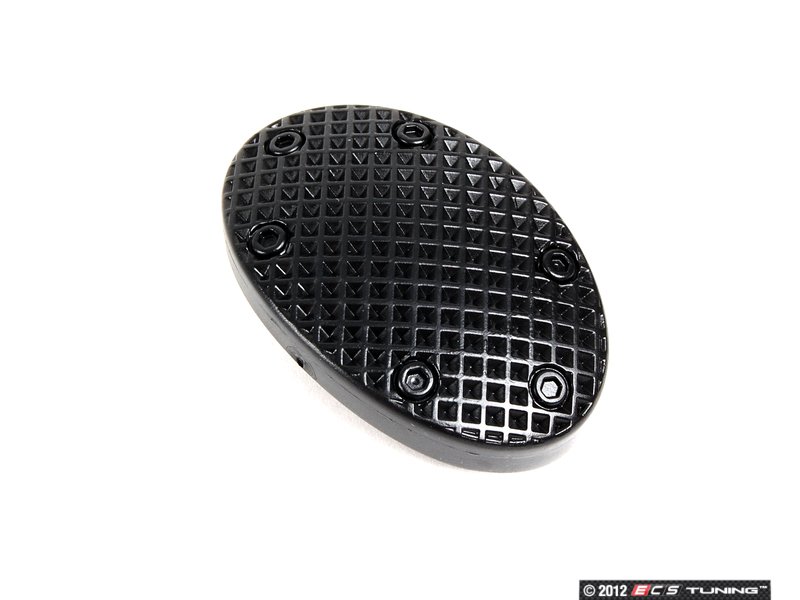

Yea, they just peal off top to bottom. All these and others linked right here:
http://www.ecstuning.com/Mini-2007-Cooper-R56-S-Coupe-L4_1.6L_N14B16A/Interior/Pedal/
Stainless finish. Rubber backing.
Regular rubber pedal.
Main kit Manual transmission.
Main kit Automatic transmission.
