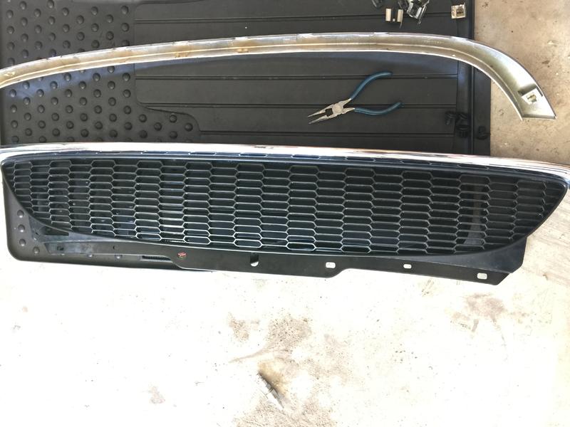

Hey guys so i just bought new black trim for my grill ( http://www.fastmini.net/blgr2.html ) and I i cant seem to find a way to separate the bottom trim from the grill. Any ideas or do you know on any other write up that shows how to remove it?

So after looking at the grill more I have figured it out. The owner before me ad put glue on the clips on each side.
All you guys have to do is unclip the two main clips on the far right and left of the chrome.
Then after I did that I just gave all the other clips in the middle a little push and chrome piece came right out
