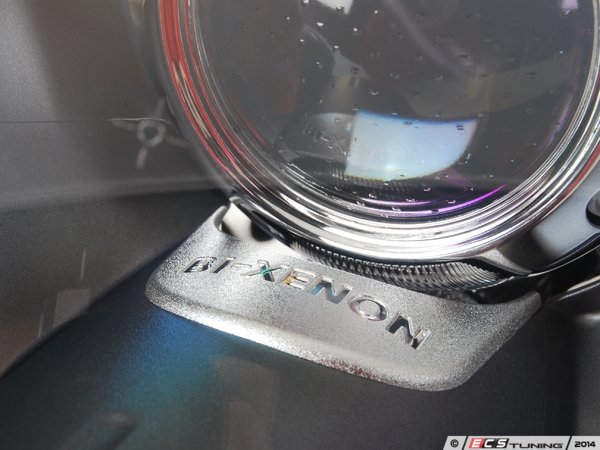

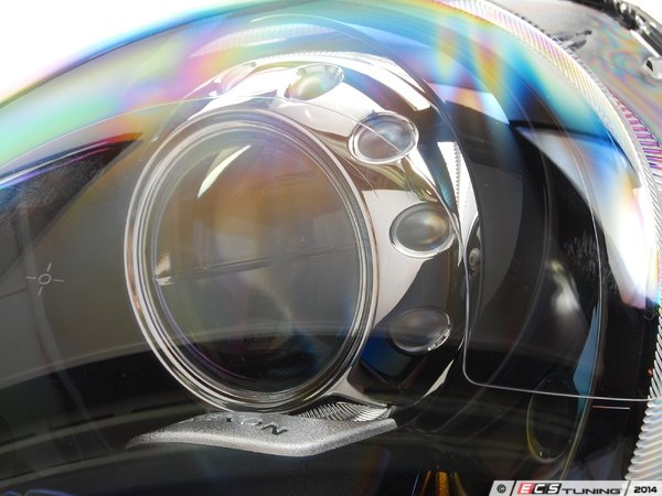

Yea we opened a box that we owned in the past and took a peak. I know what they look like and posted my findings above.
See another one recently and it looked the same. The lens has little bubble bumps on it. Maybe you got a set that was produced wrong ( manufacturer error ), but for both of them to be like that I think its a shot in the dark. Hope you can find another dealer or someone who can program in your area.
New regular bi xenon 35w has adjustable flap ( line )
New 25w Xenon Retrofit kit ( little bubbles) has adjustable flap also.

Yes you should have Hi Beams. And the kits do have some odd bump lines to the projector lens = normal. If you still don't have Hi Beam then clearly the tech is not loading the proper program.
