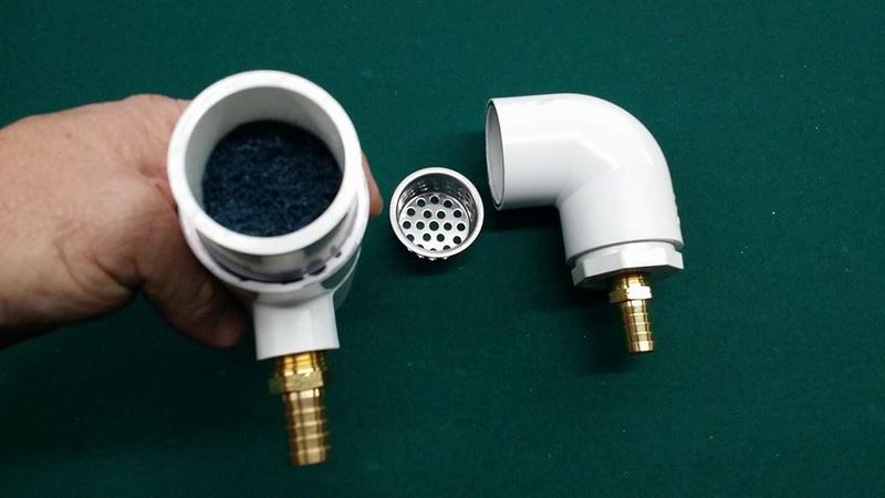

For one... I am removing the PCV system and have installed an Air/Oil separator. The two points on the valve cover are now connected to draw through an oil filtration point, then the breather to the turbo inlet is connected at a higher point so I can have clean crankcase air drawn in for better ring seal.

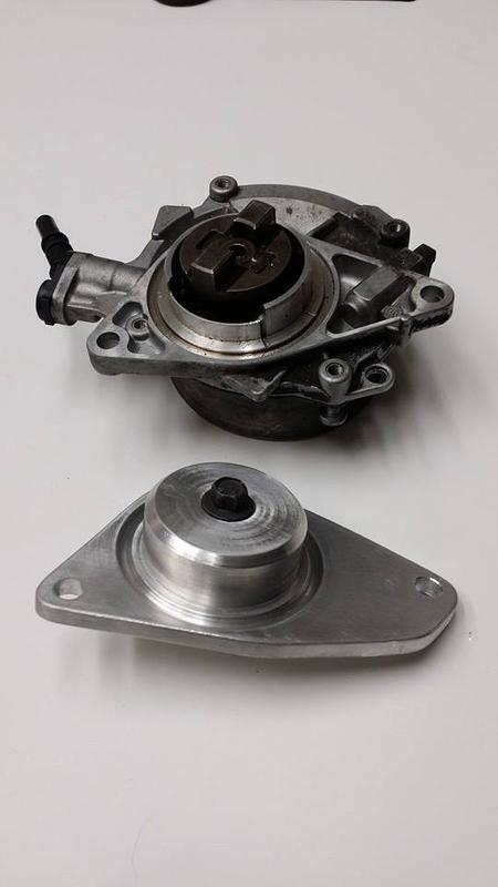

I was alerted to my failing vacuum pump by the oil dripping on the ground from the vacuum line disconnected from the rear vac reservoir. So after a LOT of searching, decided to make a block off part to remove the vacuum pump altogether. I then removed the intake manifold, bored out the fitting to 8mm and installed a check valve so the system only sees vacuum, not boost. I made a secondary vacuum reservoir which has a 13-19 hg/in sensor switch that powers a Cadillac CTS-V electric aux vacuum pump so my brakes & boost control solenoid will always have sufficient vacuum to function.
So far I have spent less money to do all this than it would have taken to replace the pump alone... and I will never have to worry about it failing again! In fact... I bet I free up a few HP from not having to turn it at all!
I will have this project all wrapped up in a week when I can get more time to mess with it. Should be a great mod to share!
