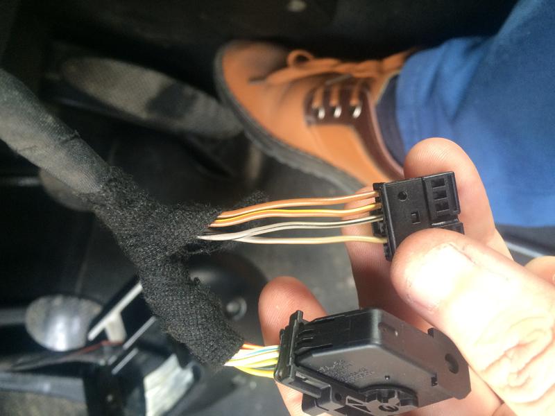

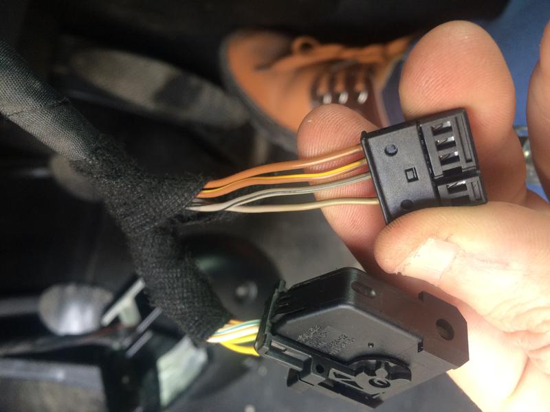

I have checked the connecters that goes from SZL, 2 of them. The one with 4 cables is for airbag, the other one with 18 pins goes directly to DDE. They both look ok to me. Is strange that even if internal error 9E28 has disappeard, in ista-d steering angle in SZL is still -1440,15 degree and fault. I don't what to do in this stage. Maybe i will try to recode SZL.
Attached Thumbnails Another SZL failure, cleaning did not help-img_3057-1-.jpg   Another SZL failure, cleaning did not help-img_3058-1-.jpg   Another SZL failure, cleaning did not help-img_3059-1-.jpg

Erjon,
Yo I recognize those connectors!
I had to order a SZL, as predicted. I finally had a chance to try the "repaired" clockspring and SZL unit...car and software didnt even recognize it. Might be because I didnt install the airbag, but I wasnt about to chance the airbag popping off because of a short circuit and breaking my hand or nose .

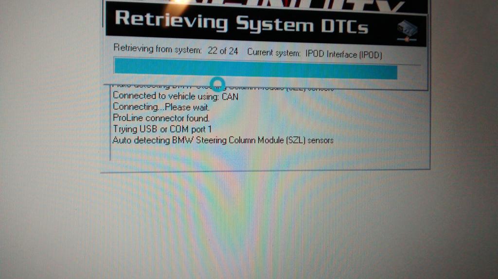

Erjon,
I installed the new SZL cluster and airbag light is off, horn works, turn signals work normally.
Well Im hoping that AutoEnginuity will "code the SZL". I cannot get to go into "actuation mode" so that I can calibrate the steering angle.
It did take some time to recognize the sensors....as per the photo below. But maybe that isnt the same as coding? I dont know the difference. The software does specifically recognize the VIN and I have the BMW software extension. But I am a novice with software, so I may skipping something.
