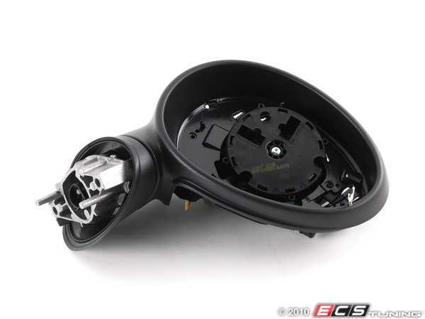

We have them here:
Gen 2 , look for the power fold in and non powerfold in. Pick the one for the option you have. They have two bolts.
http://www.ecstuning.com/Mini-2007-Cooper-R56-S-Coupe-L4_1.6L_N14B16A/Exterior/Mirrors/4
Covers are on the next page. Agiain watch for the power fold in and non power fold in options.
http://www.ecstuning.com/Mini-2007-Cooper-R56-S-Coupe-L4_1.6L_N14B16A/Exterior/Mirrors/Cover/
