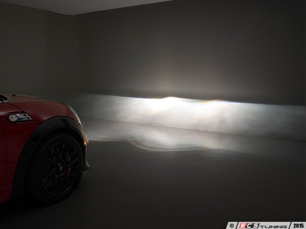

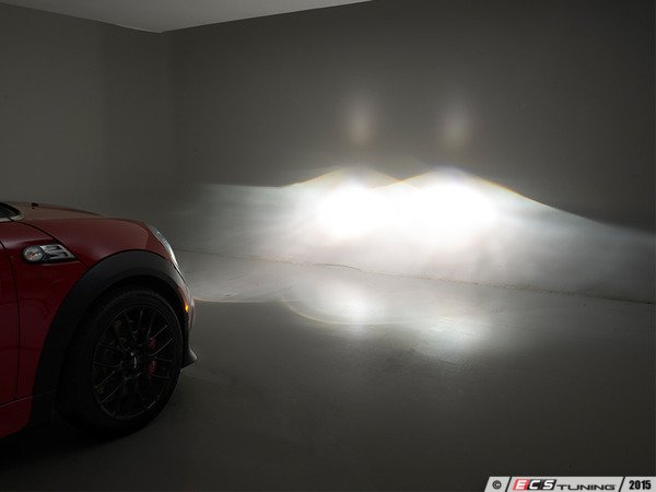

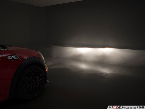

We have them here with lots of info and pics: Click through to see the cutoff and beam patterns. The DRL are bright, the ones we have. They fit the R58 and R59 models also.
https://www.northamericanmotoring.co...le-lights.html
We installed them and really like the looks both Halogen and Bi-Xenon version as they are very close to Factory design .
Xenon Version Low beam :
Xenon version High Beam : BiXenon
Halogen low beam :
