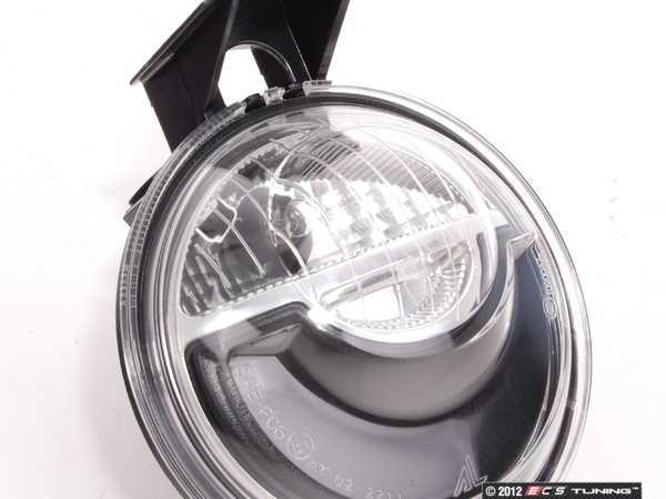

Front Fog Light With Position Light You can see the two bulbs. 1/2 upper , 1/2 lower. 63172751295

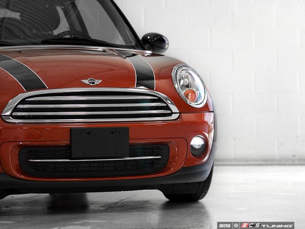

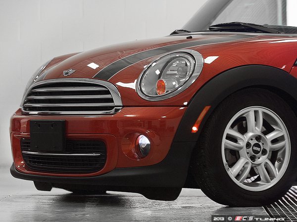

Position Only Housing lights example. ( you can see no fog light )
Position light & fog light combo housing ( fog is lower section )
