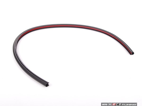

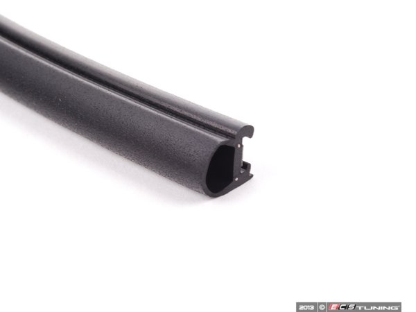

The seal #8 in the diagram above is in the middle, your does not look too bad, but I cant tell if its fully marking contact on the seal.
Here is the new seal. #8 Part # 54102755851
http://www.ecstuning.com/Search/SiteSearch/54102755851/ES156664/
