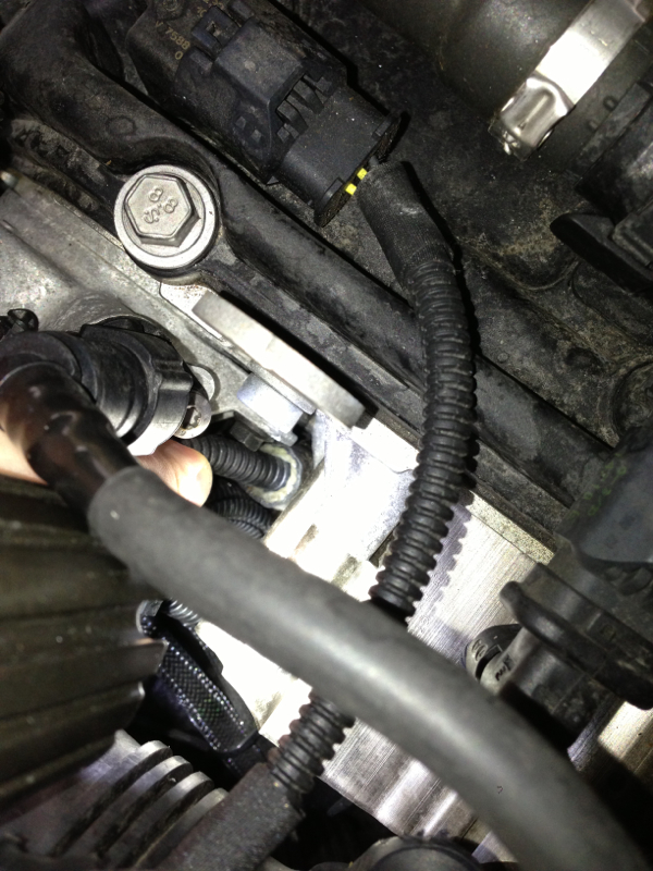

Guys!
No screw to be found in that same area as you all have. In that same spot I have this plastic thin hose (kinda like a wire cover) going in.
I gave up.
Btw. Bought my car brand new may 2011 but it was build in September 2010.
Any other way to do coolant flush on my own if I can't get or find that screw?

cub4bearindiana this is really strange...
I've looked up RealOEM for a US spec N18 MCS build date Sep 2010 and all your thermostat housing numbers are the same as mine, which definitely has a bleed screw.
I'd suggest raising this issue with your local dealer, even asking him to get a thermostat housing in specifically for your VIN no. (Rumour has it they're in short supply, though.) Trouble is; he'll say its 'sealed for life' and you won't need to renew the coolant, won't he?
I'm really curious to know the outcome of this! I wonder if anyone else on NAM with a similar MCS build date can offer any clues or has a tstat housing like yours?
Good luck. Please let us know the eventual outcome

So I tried to make another attempt to find that darn screw and no luck.
I swear I'm not that stupid lol
Wish dealer was closer, so I could ask.
Now I have all that destillated water and coolant seating here without use lol
