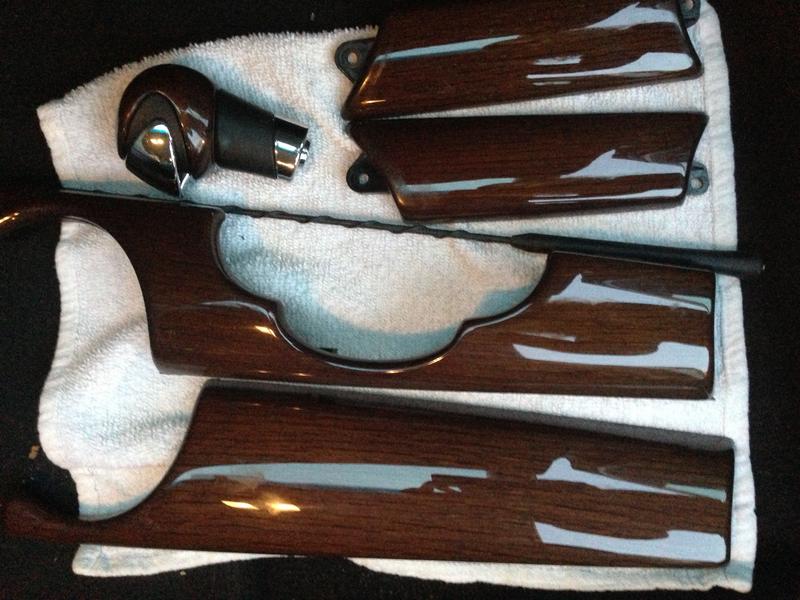

I am installing all of the wood trim that I removed from my totaled '07, and purchased a NOS wood sport steering wheel (without the paddles) from Outmotoring.com. It will be like an organ transplant!

Thank you for all of these fantastic diagrams, it is EXACTLY what I needed to see to give me a little confidence! Here is a pic of my bounty from my wrecked car.....
Thanks again, LG

Very nice dash trim, looks like the English Oak.
We have them here in English Oak . The MINI Goodwood version is the Rolls Royce Walnut Dash.

Thank you again for your help and recommendations. Yes all english oak, including the wheel. All local dealers told me it couldn't be done (the steering wheel swap) and also could not confirm that the dash could be swapped either, but after some investigating, I realized it could be done, so this will be my first "car project" ever. Should be interesting! I will post the final pics and video when completed. I will likely get the trim in quickly, but will wait for the weather to warm up a bit to tackle the steering wheel since I will likely be out there a while.
You wouldln't happen to have any diagrams of the automatic shift **** removal would you? I had help removing it, but it didn't really go that well, so I bought a new one that has the rod attached. Should I ask the dealer to do this part, or do you think I can do this thing?
