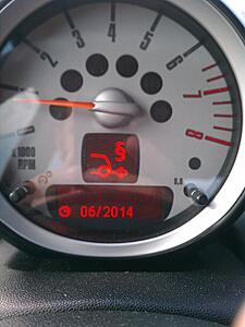

Any way to check why my service light is on?
Had this pop up this morning. Is there any way I can check what has triggered it? I have no other lights, and going through the menus, all the other service icons show more than enough time before they need action.

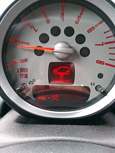

Also, what does this icon represent?

Is this message from the future? 6/2014. Have you perfected time travel? You may want to return to 2012 and take your car to the dealer as it is informing you that it is ready service. The second icon represents the scene from 'Back to the Future' when the DeLoren blasted off into time.

The mini on the lift is the inspection indicator. Look in your service booklet for the service the dealer performs. Basically they LOOK at the car. Also look in your service booklet for the definition of all the CBS icons and their meaning. The second icon is for the emissions inspection.

I was looking in the manual and didnt see the icons. Guess Ill look at my other literature.

No, it is saying that particular service is due on 6/14

Those icons are not in the owners manual, but the supplemental service booklet.
