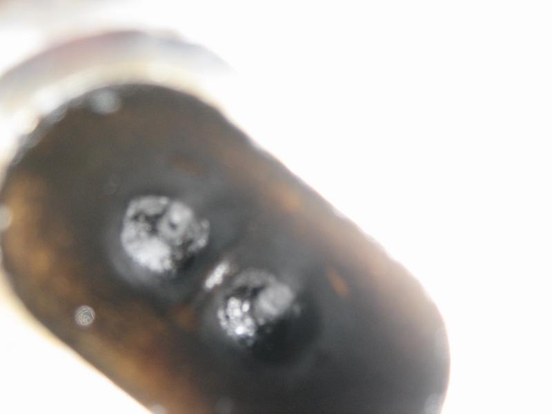

Had a occ for a while before I sold it, then I did seafoam with every oil change i've done, but even at 40k, this is what it'll look like.

Did you also have the PCV block installed? If not, oil will still enter the intake. The PCV block forces all oil vapors,etc through the OCC and collects.

I didn't bother doing that mod. I did the walnut shell blasting at 40k miles and I'm getting my Aquamist HF-4 on Monday, so I'm sure the buildup after this will be minor :D

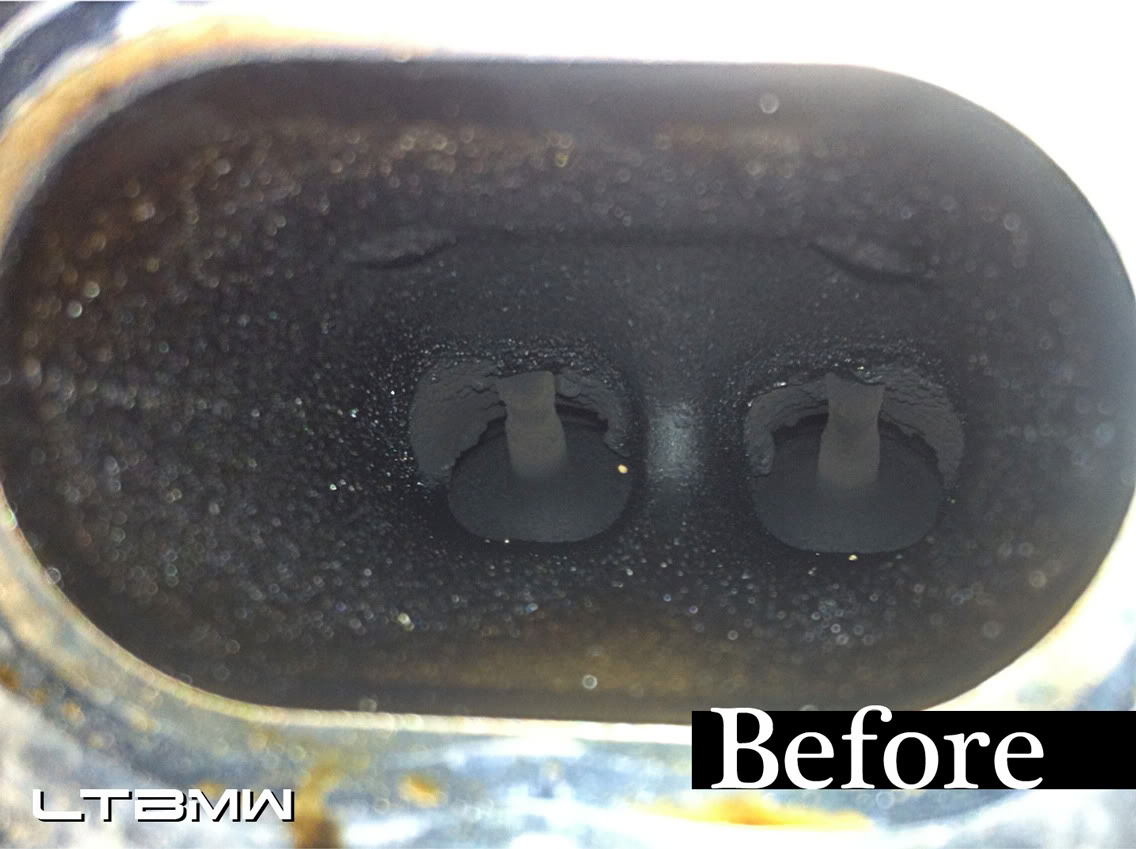

My before and after pics...
I used carb cleaner, picks, toothbrushes, brass brush, gun cleaning rod with wipes (to soak the carb cleaner), mirror (to see down into the intake to see how clean things were getting).
Took the better part of a 3 day weekend from start to test drive.
Before is on the left; after on the right.
Improved MPG 2+ MPG and the acceloration was extremely better!
Hope this helps.

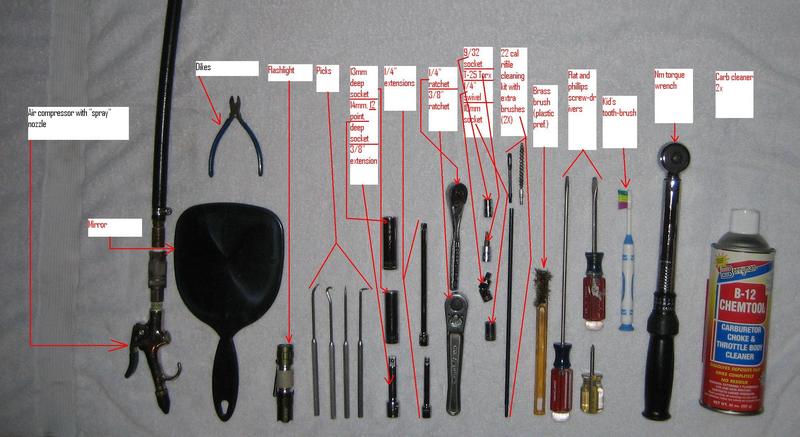

Tools I used....
Used these tools to do the job.
