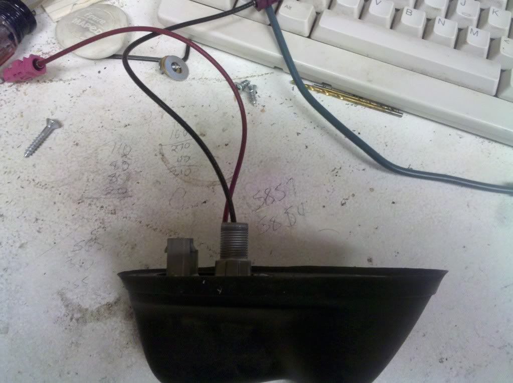

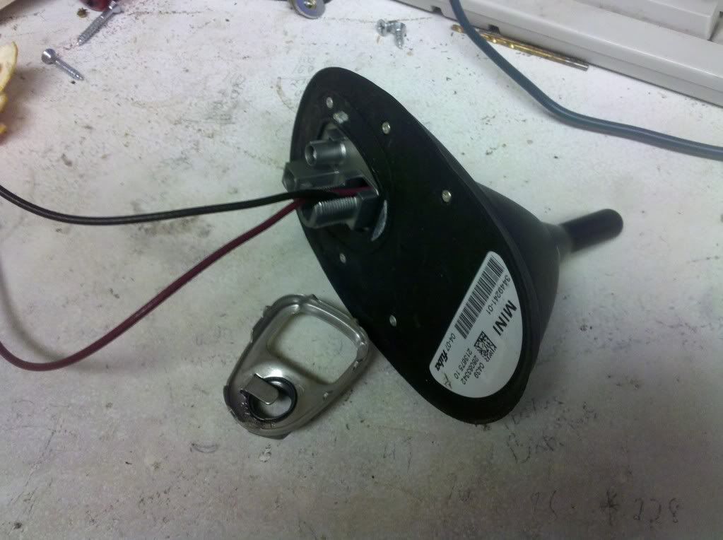

I haven't actually removed it myself, but here are pictures of the mounts -

Those photos are much appreciated! Can you confirm if the nut is 13mm, 19mm, or 22mm? All three have been noted in different threads.
